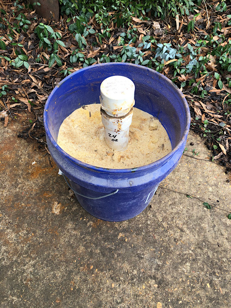

PVC pipe in a bucket of sand. Makes it portable and the sand catches any drips.
