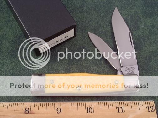

ok I saw in another post here....where a guy posted all the queen/queen city tang stamp pic....I recent saw where a guy on another site was selling a 2009 queen..it had a tang stamp incursive just like the one in the thread below....that actually dates it to 1925-1945...but I somehow think something is wrong here..it sure isn't priced like its a early 1900 knife...
here is an example of a knife.....nd also the tang pics
That Chart is fairy dated now, I believe the Gunstock in the picture to be of late manufacture and the Tang Stamp reproduced ( from the early original )- probably after the above Tang StampChart was released?
That Gunstock pattern knife was made as a special factory order (SFO) for Collectorknives in 2009.
To add to what's been said above, Queen recently came out with a Queen City line of knives that feature that tang stamp that you're asking about. Some of them also have QCCC stamped on their shield just like the 1930-1932 stamp from your chart. If you go to their site you can see that Queen City is part of their regular catalog:
http://queencutlery.com/Queen_City.html
I know that Case has done similar things where they've released lines that repeat old tang stamps and even old patterns for the packaging. This is where Levine's saying of "read the knife" comes into play.
Queen City mark was resurrected a few years ago. As bdev stated, the knives were SFO; limited number in each run IIRC. Some of the other patterns were carried by a very small group of dealers.
thanks for the info guys.....this makes it very confusing...ive also just been looking on the big auction site..and there are a few there with the tang stamp that would date them to 1922-1932...and they look brand new...im sure they are repro's as well..why do these companies make it difficult?

I did think about a SFO but wondered if the tools for stamping may have pushed the price up - but obviously used on other Tangs?
