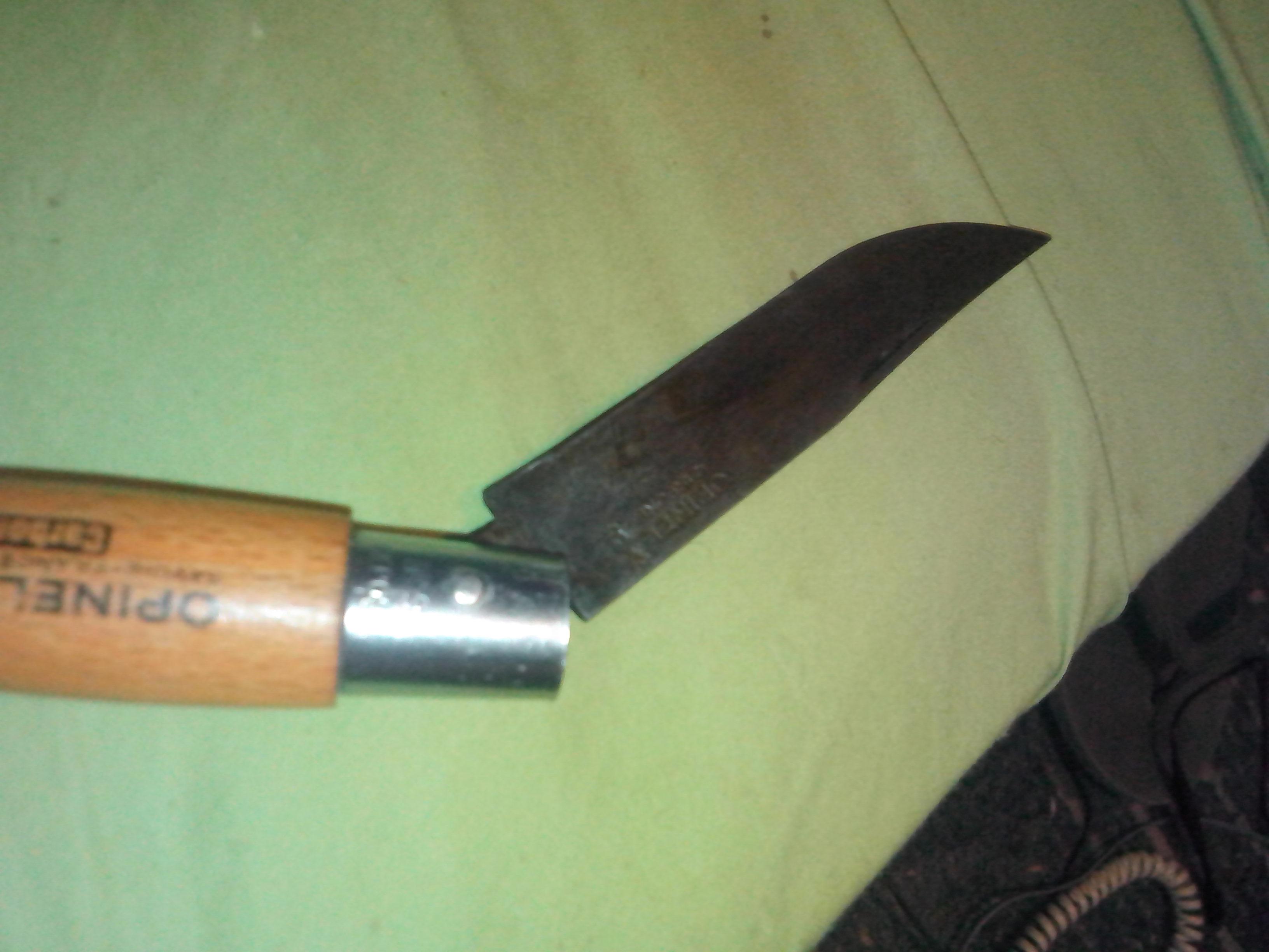

Look into rust blueing (a hot blue), its how I put the finish on my opinel and can be done with a saucepotsaucepot.
The recipe I liked best and riped from the thread involved heating hydrogen peroxide and adding salt until fully saturated, plus vinegar. I think the proportion was 2/3 H2O2 and 1/3 Vinegar.
Idk. I improvised by heating hot suace for vinegar/salt content + garlic pepper for salt + hydrogen peroxide in a suace pot.
I just eyeballed it and added more of whatever i thought it needed when evapiration occured.
Cover the metal in the hot sololution (i kept at a rolling boil) and it will foam up with rust instantly.
Wash and scrub with old toothbrush under the sink and keep repeating until yiu reach desired color.
My results achieved an almost brown bue whike the original recipe achieved a jet black color.
Make sure the steel is completely clean and nuetralize by scrubbing with baking soda after finished.
Ill post a pic of my Opi in a minute.
Here's a pic of my rust blued Opinel, my Edc knife, after nearly a year of pocket carry and a rough life including being ran through an industrial dishwasher.
Compare the carbon blade to the stainless collar around the pivot.
This is how it looks without any oil on it:

Rust bluing is not a "hot blue." Professional hot bluing is done at around 400 degrees.
Rust bluing is done with oxidizing chemicals to promote red rust. The red rust is carded with a wire wheel or steel wool, and the piece submerged in boiling water to turn the red rust black. The process is repeated as many times as it takes to achieve the color you want. Rust bluing is a satin finish, and is as durable as any bluing process.
Cold bluing is usually a copper sulphate solution which plates the metal with tarnished copper.
