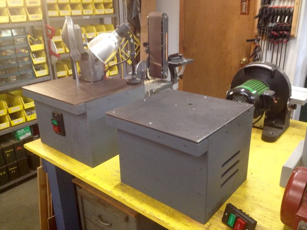

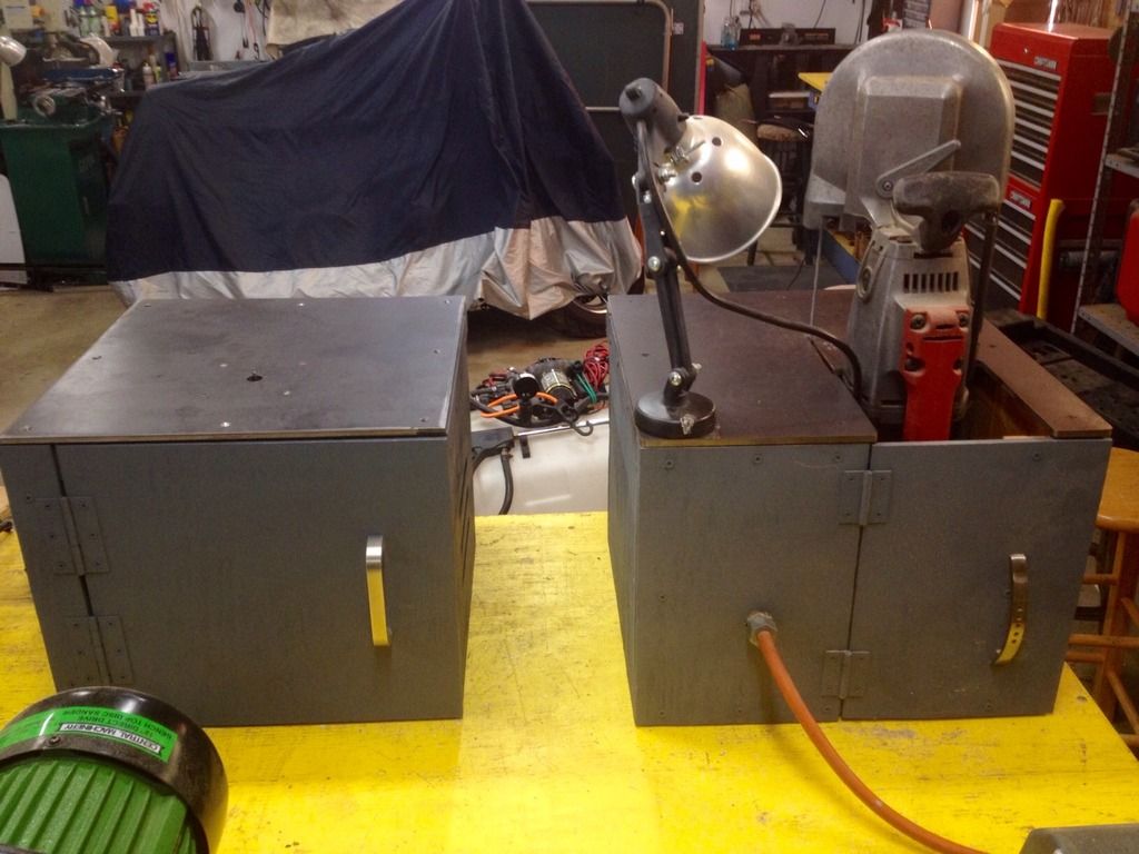

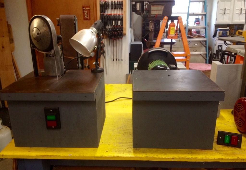

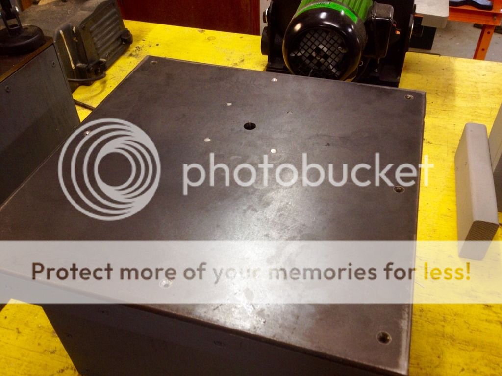

I have a full size router table that I plan on using for handles but I'm in the process of building a smaller router table to cut jimping on blades and to clean up the inside of drilled holes for things like karambits. I'm using a 15"x15"x1/4" plate for the top, 2x4's that I cut down to 1 1/2"x1 1/2" pieces for the frame and 1/4" sheets for sides. I built it to match my portaband. Right now I'm just waiting on the electrical boxes to get here later this week so I can wire it up and get it finished.
The door in the rear is for changing bits and adjusting the bit height. The switch will be wired into an outlet to power the router and a magnetic lamp I'm gonna mount on it. Then I'm going to use a 1/4" x 1 1/2" x 15" flat bar that will be slotted on both ends for a fence. I'll drill and tap the top plate and use threaded knobs to allow for adjustment. I'll cut a horseshoe of different sizes on the front and back of the fence for the 1/8", 1/4" and 1/2" bits that I'll be using for it so I can be exact with the depth of cut.
Here is what I have done so far.
