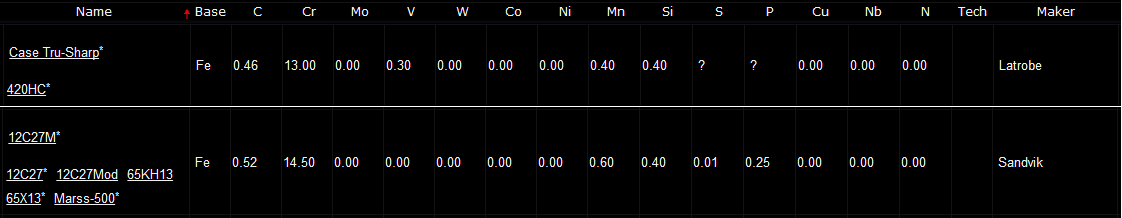

In addition to Case using 420HC for their Tru-Sharp stainless, Victorinox uses a modified Sandvik 12c27. By most accounts, the Case stainless is slightly harder than the Inox. Here is how they compare, they are very similar. Vic's Inox is slightly easier to sharpen, but Case's Tru-Sharp holds the edge slightly longer.
TrusharpVsInox_zps7e4ff584.png~original

By most reports, Case Tru-Sharp is 420HC. While the composition is a bit different, 420HC is similar to Victorinox Inox, Sandvik 12C27 and Aus8 in that they are all fine grain steels. This makes them capable of taking a fine edge (as opposed to a toothy edge, like you get with 440C), makes them tough (meaning they will bend, dent or roll but are unlikely to chip) but makes them less resistant to wear from abrasion (large carbide steels like 440C will hold up to abrasion better but may chip).
IMO, the steels feel a bit different at different hardness that result from the heat treatment applied by the knife maker (not the steel maker). Softer is generally tougher, dulls faster and may get more of a burr when honing. Harder will stay sharp a bit longer, may take a permanent dent if used roughly and may be easier to hone to a fine edge. Published/reported Rc numbers for some makers include:
55-56 Rc: Victorinox Inox
56 Rc: Case Tru-Sharp (420 HC)
58 Rc: Opinel Inox (Sandvik 12C27) and Buck 420HC
I suspect you won't find any real difference between Vic Inox and Case Tru-Sharp.
With respect to what you hear here on this forum... I think a lot of us have a strong love for non-stainless carbon steels. I wouldn't read too much into anything you've read that is negative about Tru-Sharp other than it simply isn't carbon. ;)
This said, I find hard (Rc58) fine grained stainless and hard (Rc 58) carbon impossible to distinguish in use but I can tell a difference between soft (56Rc) stainless and soft (Rc56) carbon. I find soft stainless a bit gummier and burr prone on the stones.
