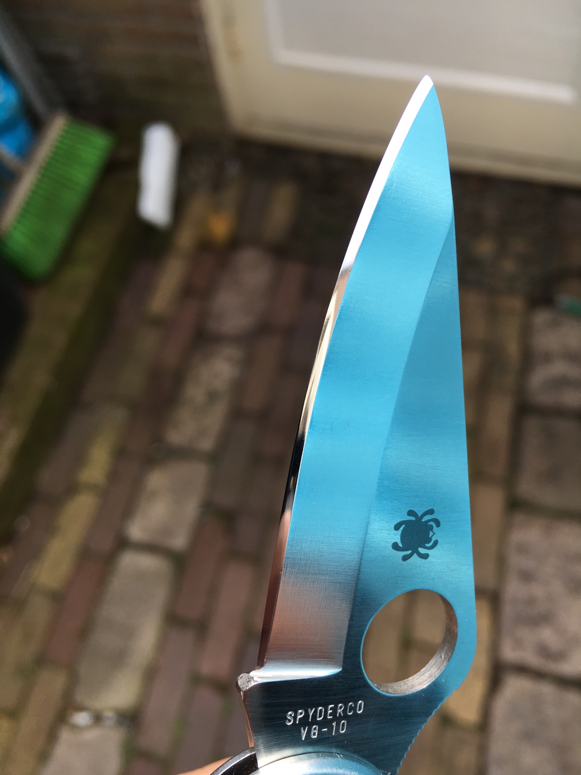

That is a big jump in steel grade. with 420 HC being a softer low end steel and VG-10 being much harder and more high end. The Delica 4 was my first Spydie too and I will never not love it. I find VG 10 rather easy to sharpen as long as it is routine and not regarding major chips or dents. I have my Delica hair whittling sharp and all I do is use 400, 600, 1000, 2000 and then newspaper. It sounds like a lot but it takes five minutes tops. If you keep a mirrored edge it will last longer and makes sharpening less harsh. I just hone the edge on an old piece of worn 2000 grit wet-dry paper when I get home from work and it stays beautiful. It is not, however a heavy use knife. because of it's possibility to chip I usually pair it with my Tenacious. I have used my Delica for food, cardboard, tape, paper, leather, fabric, and pretty much any other light use task you can think of. It has a well defined point, and contrary to some reviews that I have read, has not shown even the slightest amount of blade play. I holds an incredibly fine edge and is unbelievably corrosion resistant.

Factory angle is about 30 degrees total (15dps)
VG10 steel is da shit, very nice to sharpen and capable to give ( quite easy ) a mirror finish.
Delica, best, Knife, eveeeeeeeeeeeerrrr.
Verzonden vanaf mijn iPhone met Tapatalk
I'd be surprised if the edge angle was actually 30 degrees from the factory. None of the 3 Delicas I've had were that exact. All has to be rebeveled to be 30. That said, VG10 is nice steel an takes a sharp edge without much fuss.
