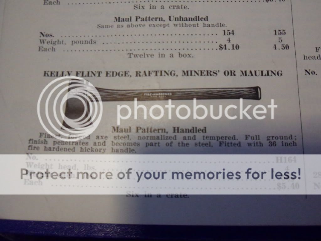

Opinion definetly has a lot to do with it no doubt. The one I have is the same as the one pictured, except it is a Vulcan, not a Flint Edge. The shape of the cheeks and bit is more like a wedge, than a typical axe pattern, especially if we are talking about falling trees. Mine would not be good for it. The one shown here might have a different profile perhaps. Not sure if all rafting axes are this way or not.

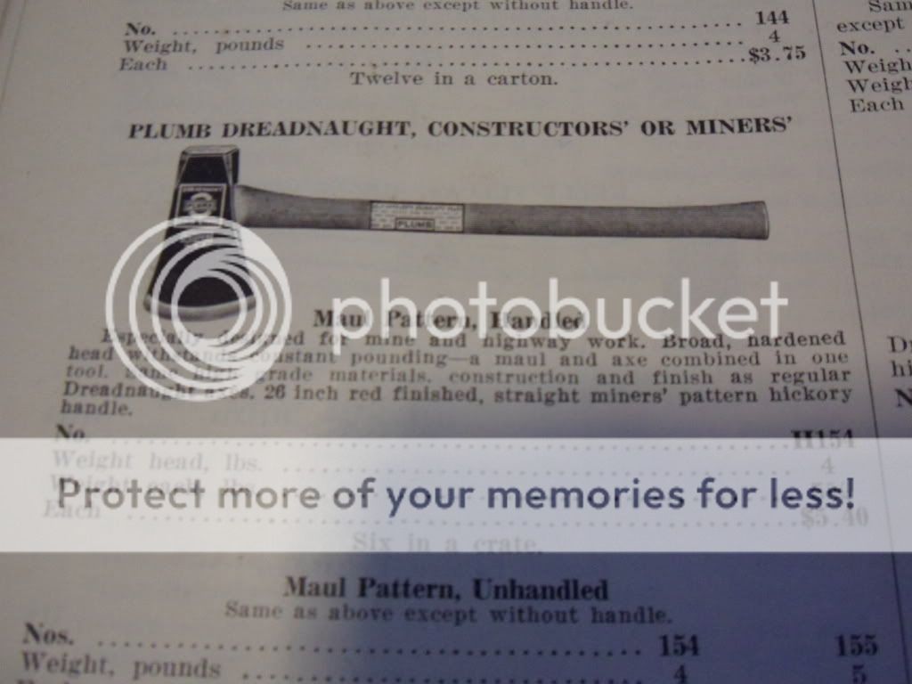

I know the Council catalog states the polls are tempered for pounding but I can't speak for the others out there. They also call this type of tool a "Miner's axe." I assume miners do a lot of spike pounding in shaft timbers?
the great majority of Council axes do not have tempered polls, per fairly clear wording on their website. pick an axe and read the product description.
what catalog are you referring to? do you have a paper catalog? (not picking, just curious).
-ben
edit: just looked again, and even the Miner's axe states it's not hardened on the poll or around the eye. wonder if you have an old catalog?
Yes I have a paper catalog and yes falling, mining etc axes have tempered polls for pounding. That is what makes them different from regular chopping axes. I've also talked to the owner of the local logging supply shop in my home town and been told the same about the falling axes he sells. He told me that most loggers never even bother to look at the edge of a falling axe, all they want to know is will it work to pound wedges.
Yes this is true now, because that is what an axe is used for.
Back in the day, different ball game.
