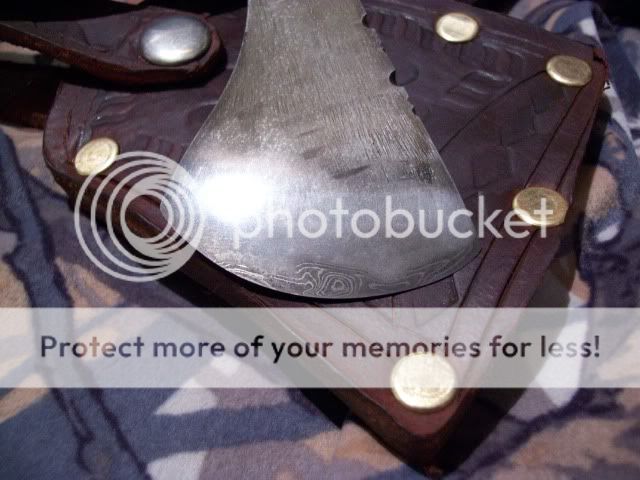

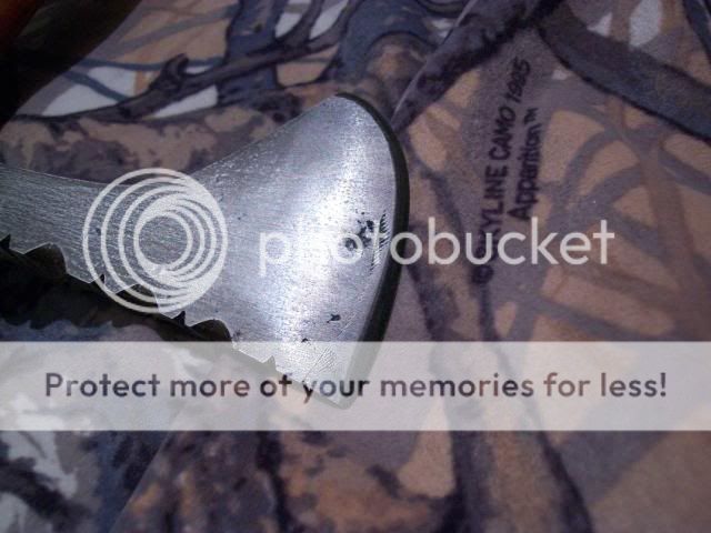

We have made some. We usually weld a bit of some kind in the spike as they are around 1030 for the HC spikes. You can use Rob Gunters Super Quench and it will harden the spikes pretty well. They flat scream in that super quench. heres a couple pics of a RR spike hawk using the head as the poll. It has a 1095(actually 1095 with added carbon. About 1.22%) bit welded in the beard. One very important thing. You must UPSET the spike a good inch to have enough material for a decent blade. You can still see the file teeth in the etch and in a couple of rough forged areas.
Heres one with a damscus bit..You can also try anvilfire.com and iforgeiron.com. Lots of guys there use railroad spikes for different things..We sell a butt load of spike knives to retired railroad workers and such. I live slap in the heart of coal country so we are covered up with tracks and yards..

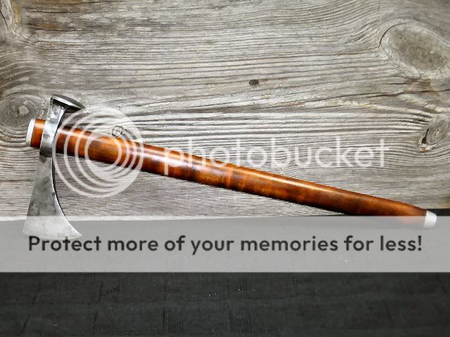

heres a spikehawk head i had made...hafting I did myself, but gives an idea of just what can be done.
