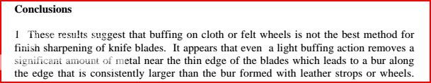

Verhoeven did a nice study in 2004 - Experiments on Knife Sharpening, it's available free online
page 25 he does some work with the Tormek and then a little on discussion that buffing wheel :)
I've found that finioshing with a loaded leather strop is key for my sharpening process and Verheoeven confirms the value of this
You may try the loaded leather strop and see if that makes the final difference for you
Verhoeven is great reading, particularity since you have a Tormek, :)
just FYI, this is the summary on the buffing wheel, the whole section should be read
available here - https://www.wickededgeusa.com/wp-content/uploads/2012/10/knifeshexps.pdf
