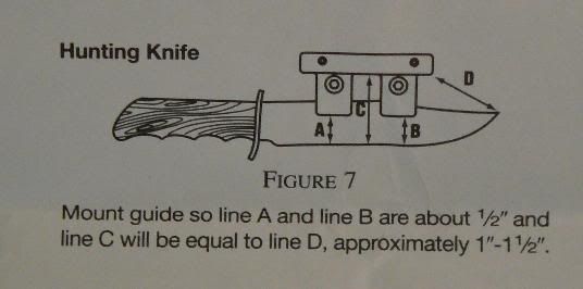

One thing to point out is to properly set the clamp so that the distance from the tip to the clamp is the same as the distance from the edge to the clamp. This is also a good rule to follow with other clamping systems... it will put an even width bevel along the entire edge.

Good points, all!. That diagram really shows how the clamps needs to be set up. Also shows why 'I' don't care for it for longer blades, but it does work.
