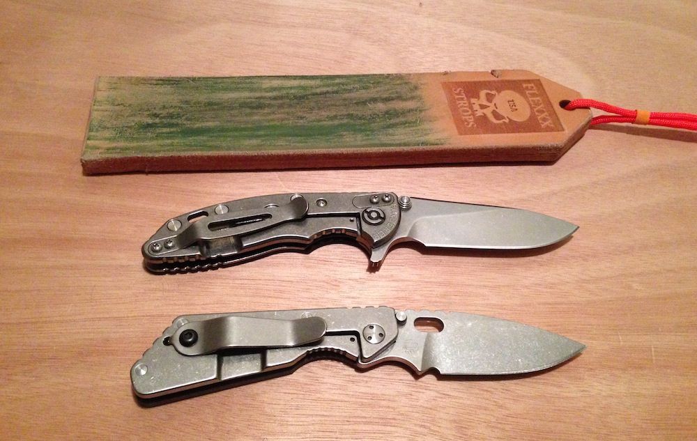

Flexxx Strops bro! Great quality leather, wood, and includes compounds with every strop. Just Do It!!! Haha!

Another recommendation for Flexxx Strops. The Pro Field II model does a great job for me.
