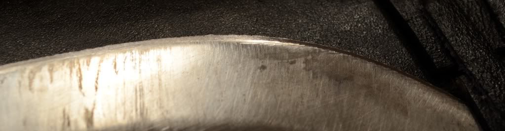

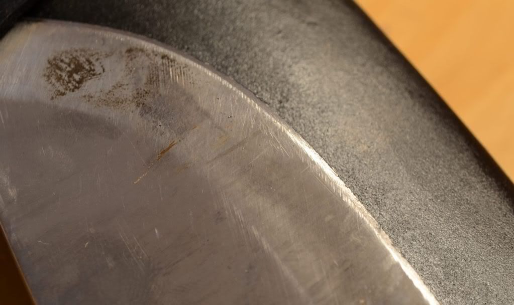

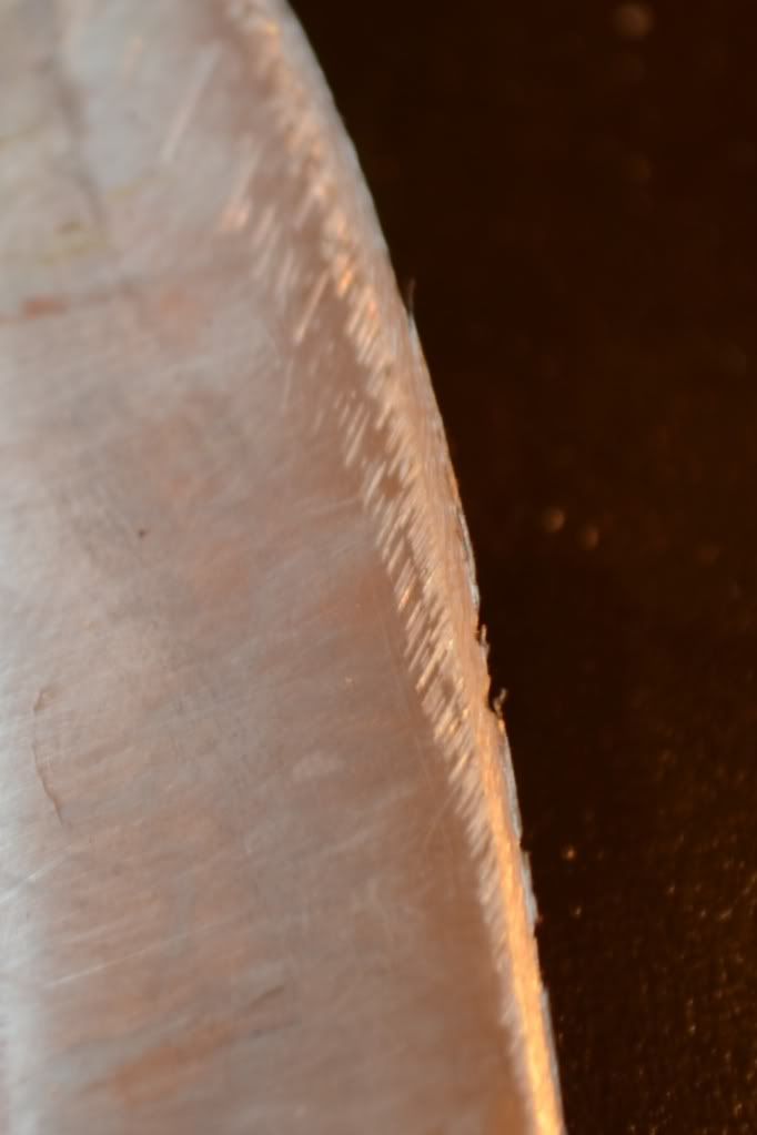

[size=+1]As a result[/size] the WWII came home with some minor damage to the blade.

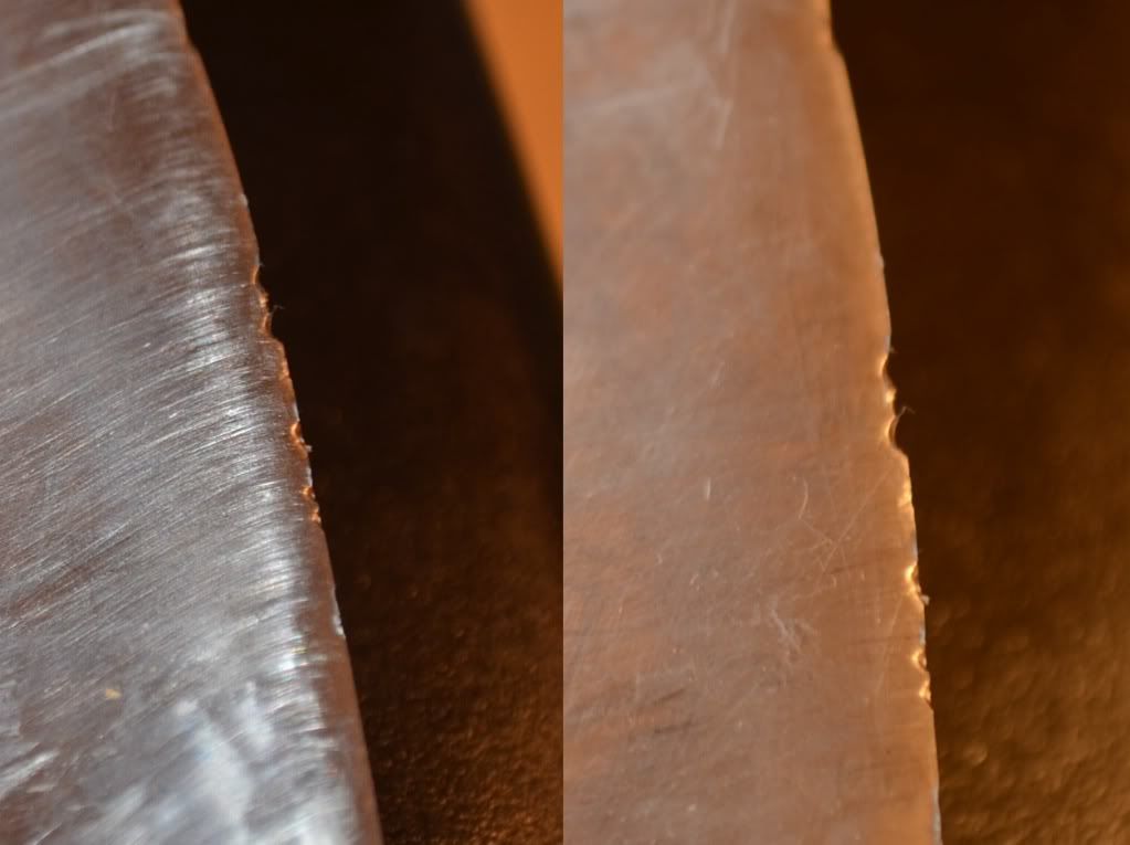

[size=+1]Two different[/size] close-ups of the same blade.

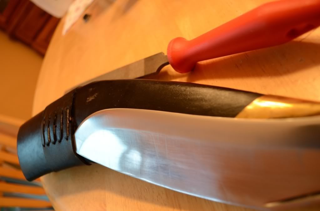

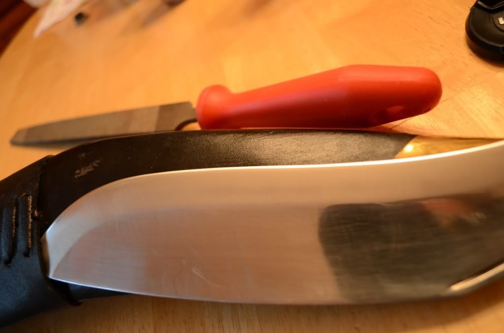

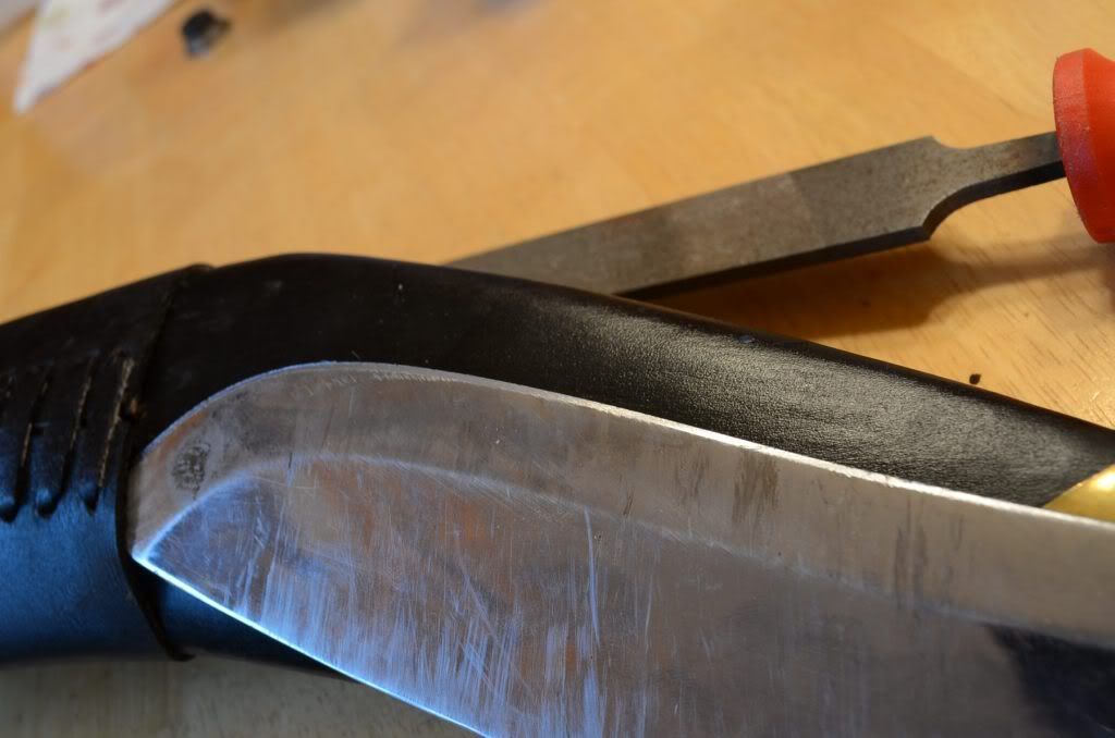

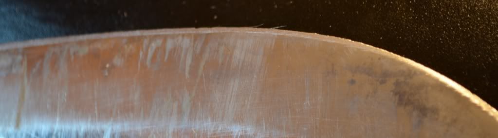

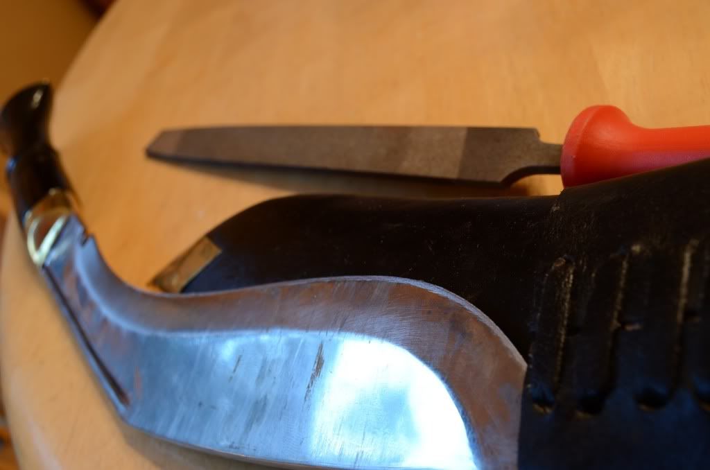

[size=+1]I use a metal file[/size] to start the process...I guess this would be called reprofiling the blade to a flat grind, however it is only temporary...just to get the chips out. I hold the blade in one hand and the file in the other and run the file along the blade. I'm better on one side than the other due to being right-handed. Here's some close ups of each side after the first several passes.
This is the side I am "less good" at, but usually by the time I finish filing I've got the pattern down much better on this side.
My better side:
A little more filing, but can still see traces of the chips.
I'm getting better on my off side:
Pretty even finish on this side if I say so myself...no trace of the chips left.

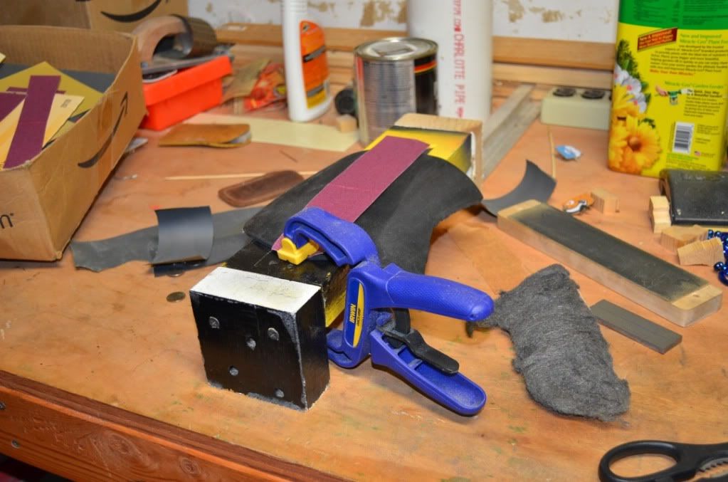

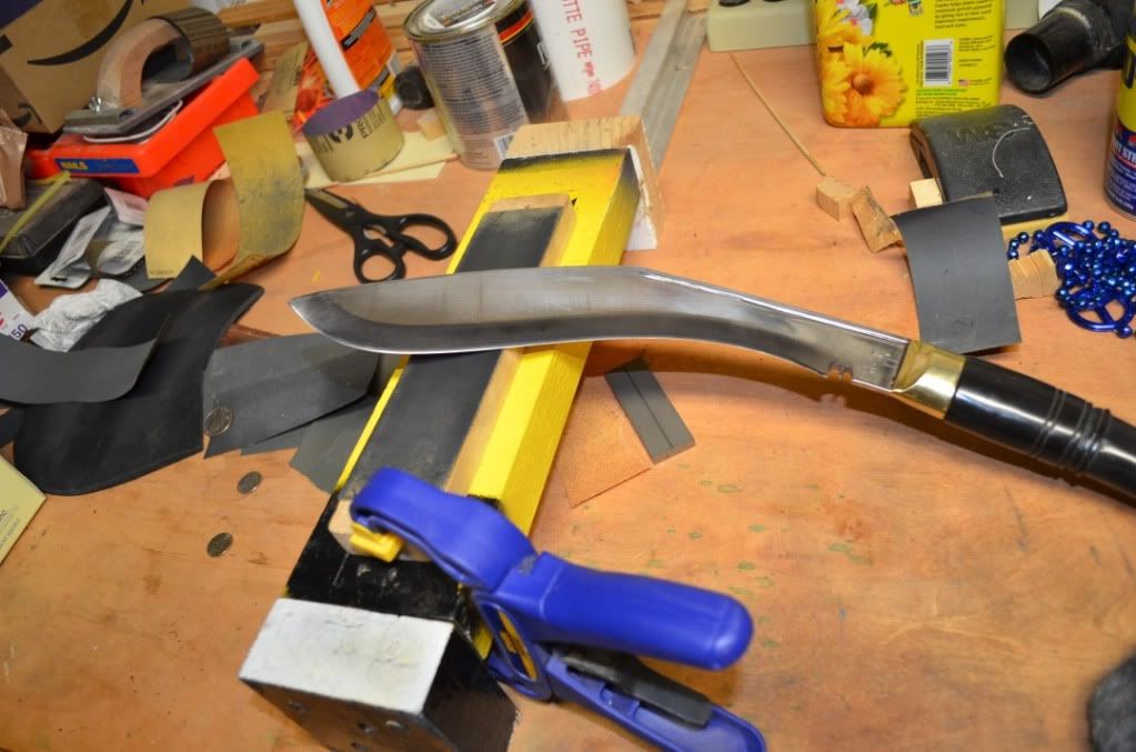

[size=+1]Now the chips[/size] have been ground out and it's ready for the sandpaper and mouse treatment. Here's my setup. A little 2x4 construction to raise the mousepand and sandpaper so I can push the blade along it without bumping my hand on the workbench.
[size=+1]I was not[/size] inclined to stop and snap pics after each grit, but I started with 150 grit to start to undo the flat grind and return it to a convex. After the 180 the knife was probably "sharp enough" to call it quits, but the compulsive in me wants a razor sharp khuk. Grits 220, 320, 400, and finally 600 take some faith to keep working through. It almost seems that the knife gets less sharp during this part of the process - it was pretty shiny and wicked looking after the 180 grip. This series of steps really polishes the blade edge kind-of making it look "softer." But once the 600 grit step is done it has started to become sharp enough to shave. Some stropping with green compound and it's ready enough for me. Could it be sharper? - you bet! But by now my compulsiveness has been overcome by my attention span.

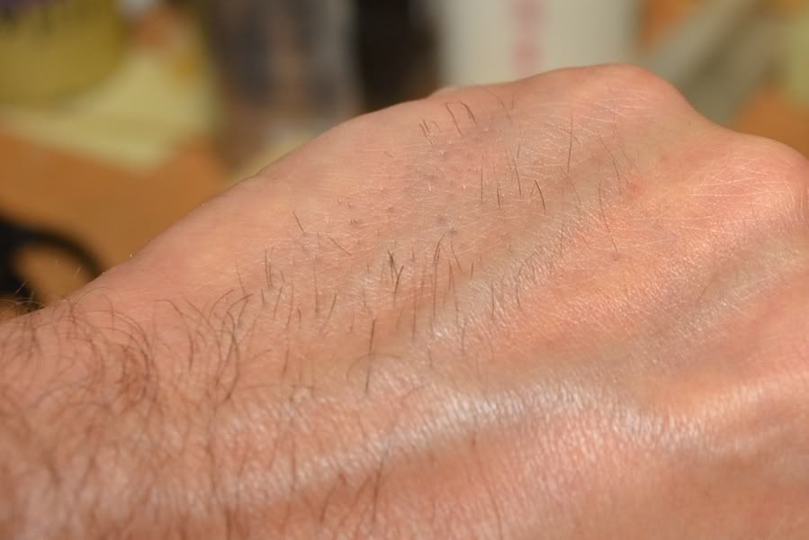

[size=+1]Shaves the hair[/size] on the back of my hand (amazing how quick these grow back, but I guess I never thought about it really...the face needs a shave daily).

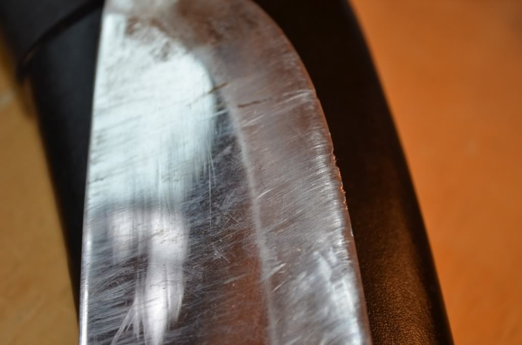

I was wondering how you got the scratching off of the blade?
My WW2 has some pretty heavy scuffing right around the kami mark. I put it back in the sheath and I guess some moisture or water got on there and the oil on the section of the balde had rubbed off from drawing and putting it away. Anyways it developed some surface rust and discoloration by the time I had gotten home. no big deal, took the course end of a scotch brite pad to it and was able to take it right off. Unfortunately I also managed to scratch up the finish pretty handily on that area of the blade. I feel like I shouldn't care but the scratches there are so uneven it's almost funny so I would like to ideally get them out. Is there a preferred buffing compound to use on the blade? I was thinking about putting on a movie grabbing a cloth and just hand buffing it until I got some of that surface scratching cleaned up. I just wanted to make sure I found a compound that isn't going to damage the blade steel. Is it possible to just rub the hell out of it with an oily rag and buff it that way?
Pormogo, I recently had the same question About my mcc. Karda suggested using fine grit sandpaper starting with about 400 going to 600 going to about 1500 grit. You can go further than that but I restored a mirror polish to my mcc. Hope this helps.
Sandpaper will really polish out scratches? I figured sandpaper would scratch the life out of it! Interesting revelation! Are you using any kind of lubricant or buffing compound or are you just using it on the "dry" blade?
So you wrapped a drill attachment in sand paper? I think I'll just grab a little square and try and rub it out by hand.
No, I had a small buffing attachment for my drill it was cotten. I hand rubbed the blade with the sand paper

Here's the paragraph where I talk about getting the scratches out.
bric said:
... put some WD40 on steel wool sitting on the workbench and ran the flat part of the blade across it on each side several times to clean off some of the wood residue and buff out some of the scratches. Also, on the 400 grit, 600 grit and the stop I took some strokes with the full flat side of the blade to further buff it out a bit. Once done I spray some WD40 on kleenex and lay the kleenex on the steel wool and wipe the knife back and forth on the kleenex to get the compound off. If you're looking for a great way to badly slice your finger(s) you can pick up the kleenex with the oil and wipe it back and forth on the blade (ouch!).
What I'm talking about above is have the sandpaper on the mousepad and hold the blade flat on the sandpaper and push it away from you (one hand on handle and other hand on top flat part of blade) - sharp edge facing you, rubbing the scratched surface of the blade along the sandpaper. Pay attention doing this as well because your palm (the one on the flat part of the blade) will be near the sharp edge of the knfe and if the knife catches or otherwise stops moving forward while you are pushing, your palm could keep moving forward and get sliced by the blade.
