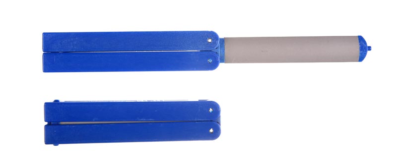

I have an EZE-Lap version (10") and it works pretty well. They aren't too expensive either; I think I paid about $24 for that one a few years ago. I noticed a little bit ago, while checking online, EZE-Lap also makes a portable, foldable oval cross-section diamond hone in two different grit choices (600 & 1200). So that might be worth a look, if it interests you. A vendor pic is below (1200-grit model# 590 is shown; the 600-grit is model# 591 w/a red handle):
