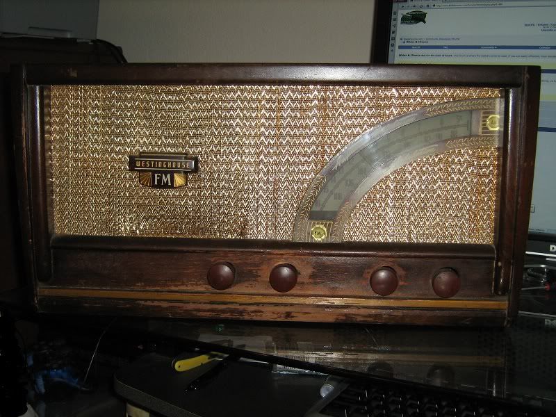

Greetings all.
A few months back I bought a 1948 Westinghouse AM/FM radio with a project in mind.
One of my hobbies away from knives, is old time radio. So I bought this radio to rip out the original electronics and replace them with a modern amplifier so I can run my ipod through it and listen to old radio shows.
Well... the time has come to refinish it. I started with this:

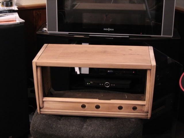

And tonight, I have this:
I've never refinished wood before. How rough should the surface be? I stripped it the 80 grit sandpaper and it doesn't have any rough spots, but it's not exactly smooth.
Would I be ok to go ahead and put the finish on, or should it be smoother or rougher?

Very nice project! First, what finishing materials are you going to use? Are you going to stain or go natural? If you are going to stain I would sand to at least 180 grit and probably more like 220. Otherwise your color will be uneven. You could use a "all in one" finish that is basically a finish with the stain already in it. These are more forgiving of uneven sanding because they do not penetrate the wood like stain. They are more of a colored top coat. Whatever you decide be sure to post some pics of the finished project.
A little part of me would like to leave it as a natural finish, but that would clash with the gold fabric. I am going to stain it. I found a pretty nice finish that has just a little bit of red in it.
I'll take your advice and sand it with some 220 tomorrow afternoon and then blow all the dust off and give it a shot. I've got a satin clear coat for the end because I don't want it overly shiny.

Wood finishing is really an art form all it's own and there are so many different ways to accomplish drastically different results. If you had built it from scratch I would recommend doing samples on some scrap. Since that's not possible you may want to try it first on part of the inside that won't be seen. If the sample area comes out blotchy they sell a wood conditioner that you apply first to help even out the color. Definitely sand more, it's just like painting. Every little imperfection will be magnified once the finish is applied. You can mix colors to achieve the desired results as well as long as they have the same base. I prefer wipe-on polyurethane since it is easier to apply and dries faster. The downside is that it requires more coats to get the same build of finish. The biggest thing with finishing is having patience. Make sure you have everything you need handy before you start. You don't want to stop in the middle to look for something you forgot.
Most importantly don't throw used rags in a pile or in the trash until they are dry. The buildup of heat as it cures can start a fire when placed next to combustible materials.
Good luck, I'm looking forward to seeing how it turns out. It's a cool project and always nice to see something old turned into a useful object again.
Another thing I forgot before is that when hand sanding you should go in the direction of the grain. This will minimize the visibility of the sanding scratches.

I would be taking it down to more like 400 or so. Definitely get tack cloth. Take your time and follow the instructions of the finish you are using. For something like this, I would be tempted to stain and then finish with tung or boiled linseed oil.

I just finished sanding down to 320, and I'll probably finish on 400 tomorrow (my arm is about to fall off) and I picked up some tack cloth at Lowes on the way home from work this afternoon, so I'll give a good cleaning with that and hopefully get started on some color hopefully later this week... it's too cold and damp today to start.
One other question while I'm at it. You can see in the first picture that there's a gold stripe under the knobs and I'd like to recreate that. Should I tape that section off before I do any staining and then hand paint it later, or will a paint adhere to stain very well? And what about gold leaf?

You probably don't have to bother sanding it with the 400 unless you really want to. I usually sand to 220 before staining and use 320 or 400 between finish coats. If you go too high before staining it won't absorb it as well. I wouldn't be worried about the paint adhering to the stained wood, but it may be harder to cover the darker color. I don't think it would stick to the clear coat well though, so you might as well just tape it off to play it on the safe side.
As far as keeping the finish the same as the original was, I wouldn't worry about it either. It's not like you're doing a restoration, it will be something unique and I think the satin finish will look good on it.
