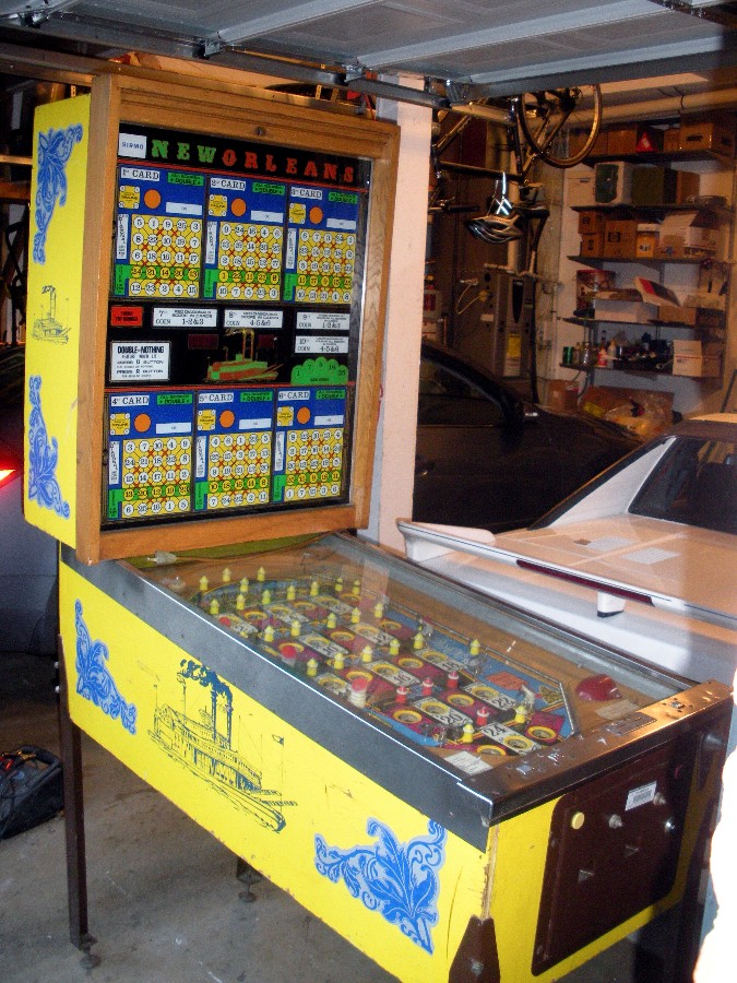

It is in pretty good cosmetic condition for a machine made in 1984 and given the hard life it certainly had in bars, pubs, and game halls. It came without the key to open the front, and with only 2 of the 5 balls needed to play the game. I powered it on just to see what would happen. The lights on the playing field lit up, and the digital display read all "A"s (which looks like lower case c). So, obviously not working (which was as described in the Craigslist ad). The project is ON.
Before buying it I discovered it was a solid state game, which gave me some hope that the machine would be pretty easy to get going again. The older electro-mechanical versions are said to be quite challenging to rebuild. And let's face it, I'm more familiar with electronics than electro-mechanical devices.
After getting it home I did a little research online and managed to find an online copy of the technical manual, as well as pictures of how a working machine should look inside. That was quite a boon.

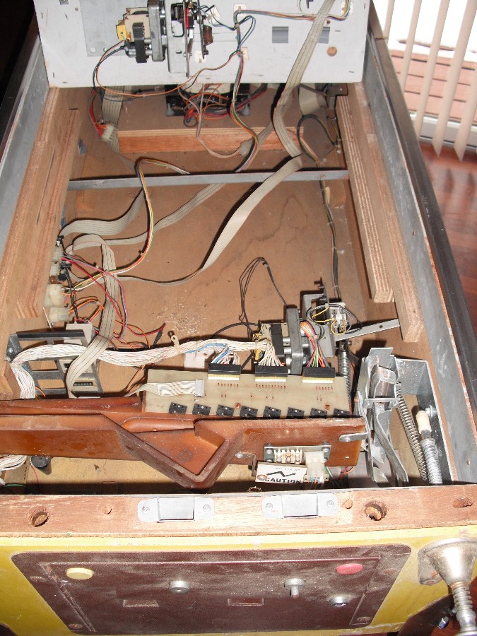

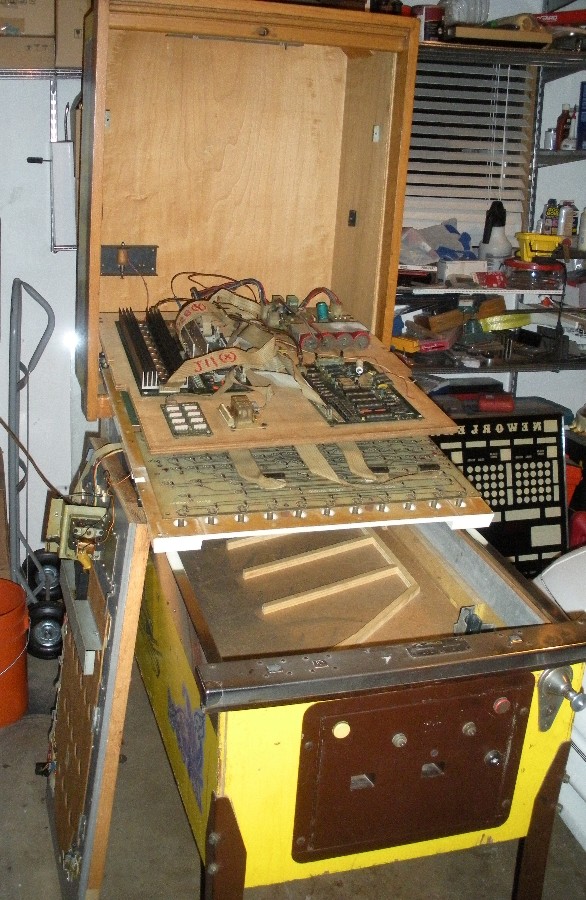

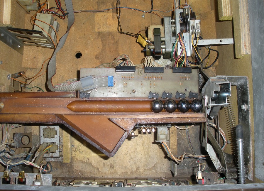

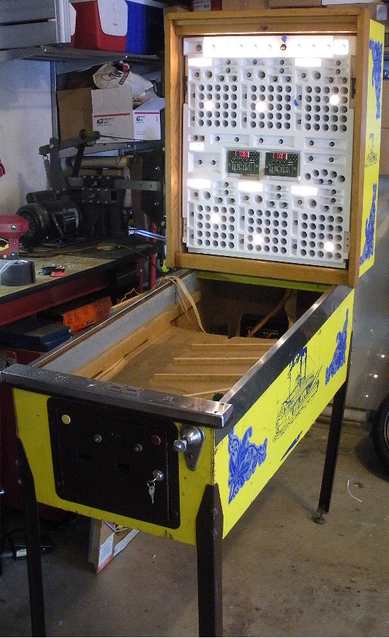

The first thing I did was remove the glass to gain access to the play field, then lifted the play field out of the case to gain access to what was beneath.
What I found there was pretty clean, with a few exceptions.

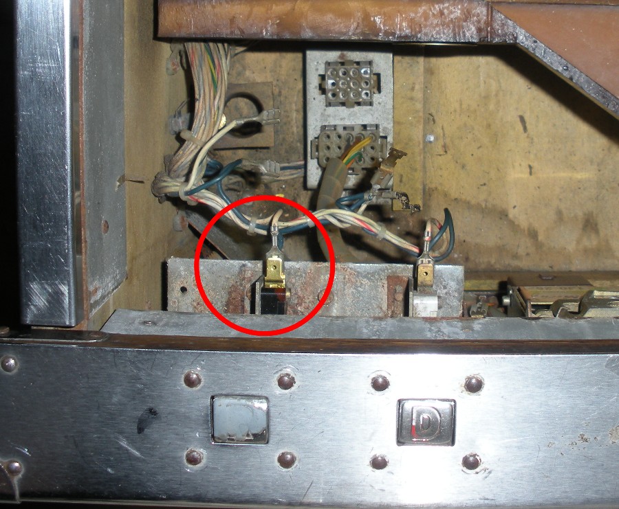

One of the exceptions was the pair of "micro switches" that were under the payout buttons "R" and "D" (for Regular and Double-or-Nothing"). Needless to say, these buttons got HEAVY use, as evidenced by the absence of chrome on the R button. Likewise, the switches beneath the buttons were beaten to hell and gone, and were broken. So I replaced one (as seen below) and then the other. The one circled in red is the new one.

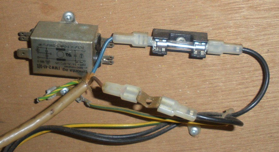

I also found what looked like a speaker wire that came down from the inside of the top part of the machine, with cut ends laying loose in the bottom box. I had no idea what that wire was for, as no such wires appeared in the pictures of the inside of the working box.
I also found one of the pieces of the original circuitry that had been totally bypassed in a piece of what I would call "field re-engineering".

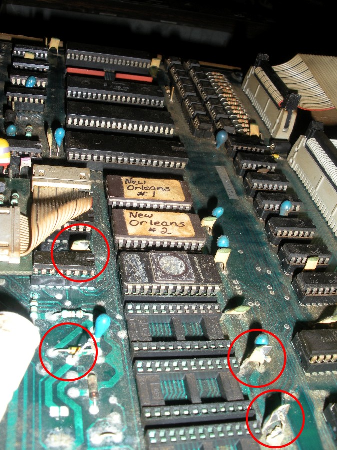

Next I opened up the top part of the machine to gain access to the main computer and supporting circuits. The first thing I noticed was that the myster speaker wire was connected to the telephone interface card, and was obviously used by one of the previous owners to enable remote control of the machine, so I disconnected and disposed of those wires.
I was told to look at the fuses first, so that's what I did, and they seem fine. I was also told to check to insure that the battery on the board (used to sustain system memory during power outages) was in good condition and not leaking... and that seemed fine. But when I looked more closely at the circuit board I started noticing some of the ceramic capacitors had begun to decay.

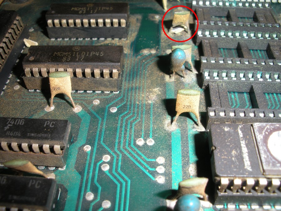

Taking a closer look at the schematics in the technical manual I deduced that the broken ones were like most of the other small ceramic capacitors on the board, 22 micro-Farrads, which was consistent with the way these were marked.

I made a bit of progress today. I reconnected an electrolytic capacitor that had worked loose and replace one of the smaller ceramic capacitors that was in the battery circuit, checked that all the fuses were viable and powered the machine up. First time through nothing happened, but when I laid the main processing board out again and powered it up, things came alive. Not sure what happened, so I don't know that I can trust it. Anyway, I put the processing board and the light board back up and power tested it again, and it came on.
I then started testing out some of the functions and switches. The switches all seem to work. The coin switches registered credits, and the operating switches correctly reflected my consumption of the credits. However, I could not get the unit to go into play mode. When you leave it idle for a while it switches into sequenced light display mode, which I used to diagnose which of the bulbs don't light up. I tagged those that didn't light with blue painters tape. When I found one that didn't light I tried replacing it with one of the new bulbs I got yesterday, to no effect. I need to determine why that is.

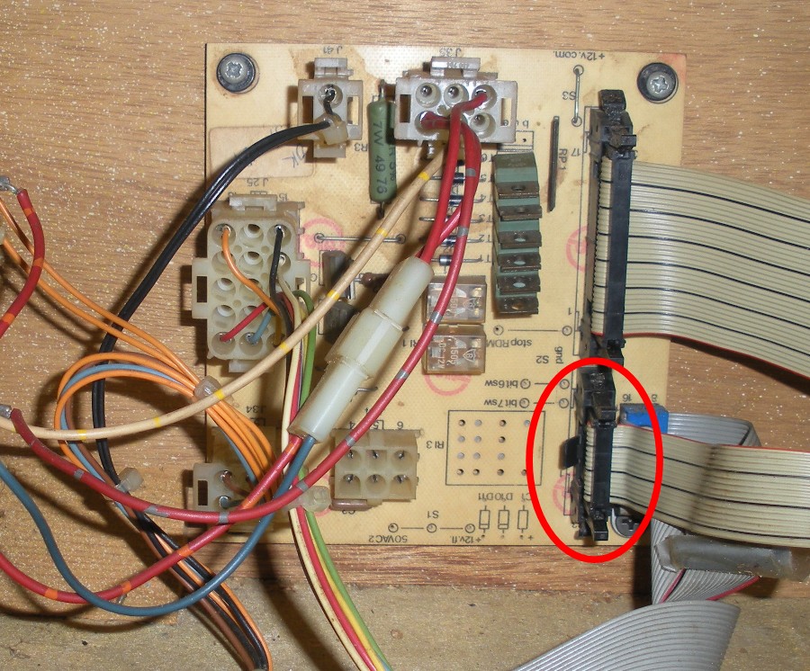

So I decided to take the play table out again to have a look at the underlying parts. And that's when something weird happened. Apparently I put some tension on the ribbon cable connecting the play table to the table split printed circuit board because when I did that the cable AND the connector came out.
Not being discouraged, I broke out my fine tipped soldering iron and reconnected the connector, then reinstalled the PCB.
It may be that the repairs to the compromised PCB have addressed the problems with the table not going into play mode. But until I can figure out and correct the problem with the ball lifter, I don't feel like assembling the table again.

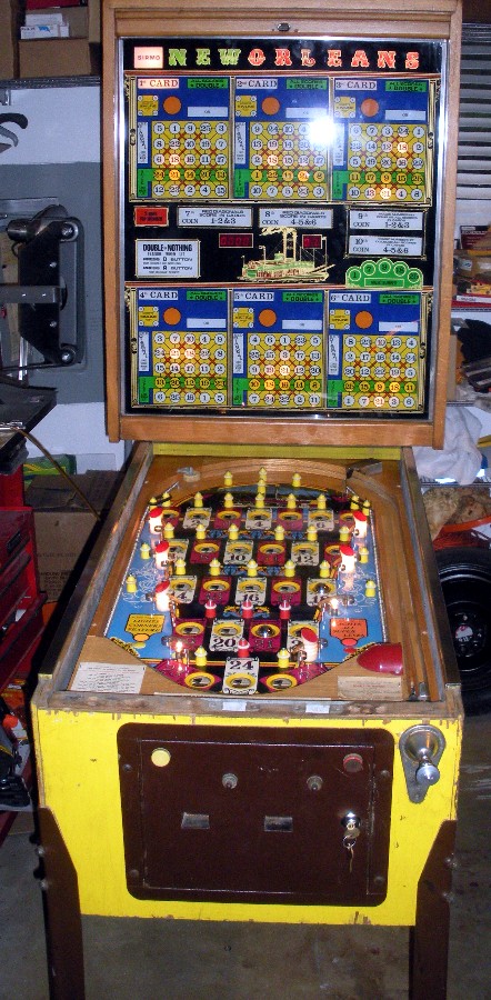

Long story shortened, this sequence of events can't happen while the machine is disassembled. So this morning I decided to reassemble it.

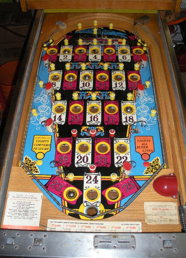

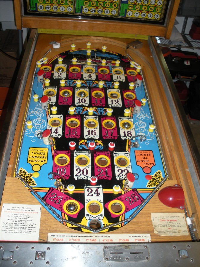

Much to my delight, when I did so the game showed that it actually is now working... at about 90%. The picture below shows my first game with two shots already taken.
I played a few games to test things out. I found that the following things are working:
A) The switches in the holes all seem to be working (at least I haven't found any dodgy ones yet)
B) The vast majority of the lights on the board work (card 1 has the most dead lights)
C) The game scores correctly for regular and double scores (at least as far as I can tell)
D) The coin accepting mechanism works fine and generates the correct number of credits
E) The rollover lights work as expected and the scoring on the features seem to work correctly too

4) The buttons used to trigger "Collect", "Regular" and "Double or Nothing" get stuck when pressed. I'm considering installing purely electronic buttons to sidestep that problem.

On Saturday I found out why the balls were occasionally not making it to the ball lifter after being dropped from the pay table. The ribbon cable on the underside of the play table was hanging in the way. When I pushed it out of the way that problem was solved.
With that problem gone, the game became essentially 100% playable. I haven't had to lift the play table since, except to tighten a loose light bulb under the Corners Feature push button.

I even managed to get the button bar assembled in such a way that it now functions without the buttons sticking, so I've abandoned the plans to build a second (purely electronic) button bar. I'll just reconnect this one, once I'm done working on the play table. I also need to make sure the play table is level. At present the balls tend to drift to the right and the bubble level confirms it's a few degrees off level.

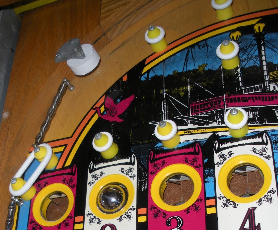

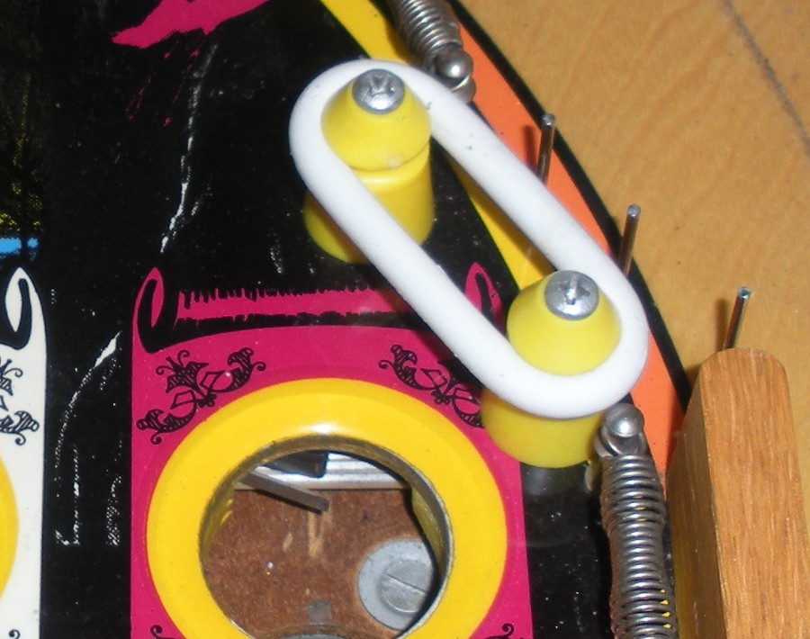

Today I expect to receive new rubber O-rings to use on all the bumpers. I'll take before and after pictures of that. Once I have new rubber and a level play table I will reassemble it and lock down the play area.
Tonight I did some work intended to level the playing table. Since I've had the machine the back legs showed signs of stress, as they were bent at the top and slightly bowed in. So I got a small work table, propped up the rear, and removed the back legs, one at a time. While they were off I took my blacksmith hammer and pounded out the dents against a 90 degree angled block that stood in for the anvil I don't own. The legs are straight and true now, and after reattaching them I set the leveling pegs so the table now lays true.
I played a few games to confirm that the ball no longer drifted, then decided to lower the back end a bit more so the ball didn't fall so quickly to the bottom. Now the game plays like I remember... the ball has great action against the new rubber, and moves gracefully across the board in both directions.

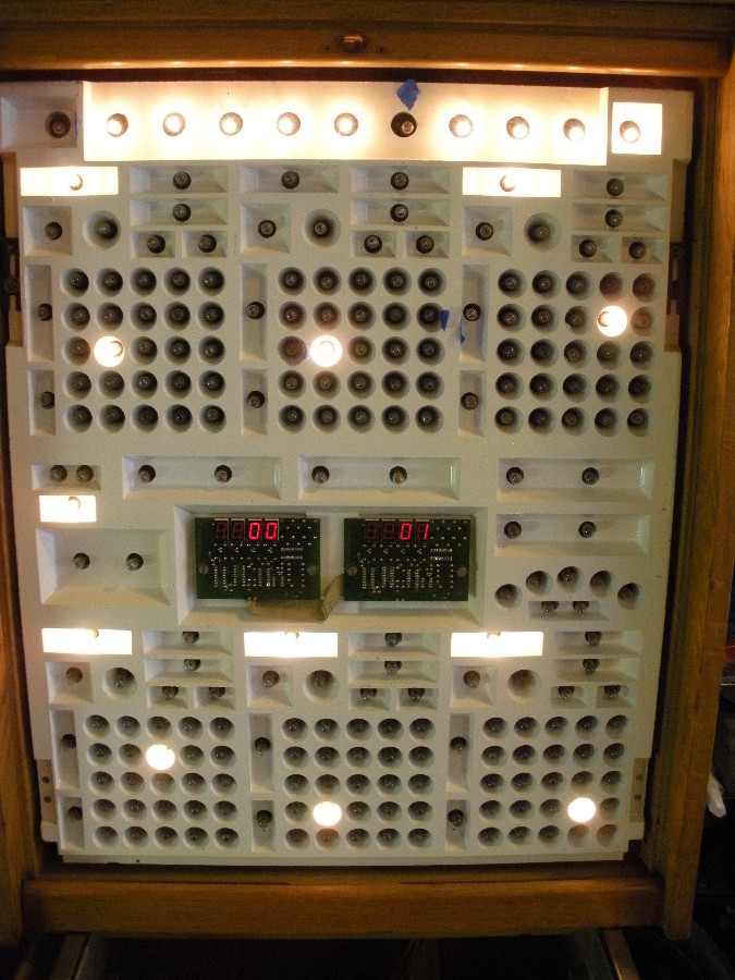

However, all along there have been several lamps on the display board that just would not light. It was easy to ignore the problem... but I want the machine operating at 100%, so it bothered me.
I noticed that the only part that was directly involved in the circuit was a single 1N4003 diode for each lamp. So I decided to replace them and see if that helped out. I found that some had previously been replaced with 1N4004 so I looked around and found that Radio Shack had those in stock. However, typical of Radio Shack, they had very few in stock and they were expensive. I did notice that they also sold mixed bag of 25 diodes for the same price as 4 individual diodes, and when reading up about those packs I noticed that they always had 5 of the 1N4004s in them. So, two packs and $7 later I had 10 of the diodes to solve my problems.
I just finished replacing the diodes on the board and am pleased to report the lights all light up now when they are supposed to, and there are no more lights coming on when they shouldn't.
