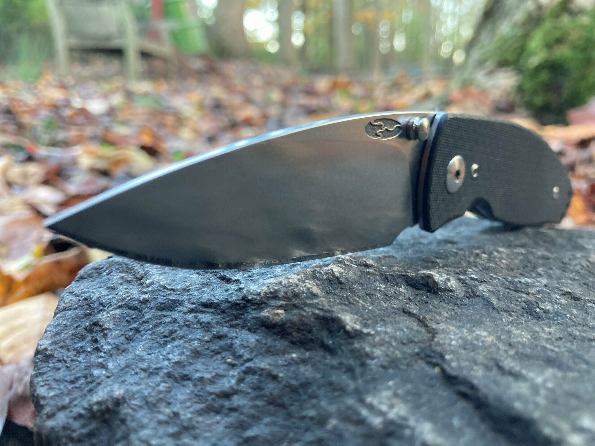

I have two knives on which I have replaced the standard Neutron studs.
The studs on the Neutron are press (interference) fit, and I found them too tightly connected to each other to pull them apart. So you have to very carefully cut one of the studs off with a Dremel and a diamond wheel (put a thick layer of blue masking tape on the scales and the blade, so only the studs are uncovered).
Then, if you look at where you just cut off the stud, in the center of what is left of the cut off stud you will see the shaft of the stud that is still attached to the other side of the blade. Set the stud that is still attached to the blade inside a white plastic (nylon) washer that is deep enough to completely accommodate the length of the remaining stud. Lay the washer on a hard surface (concrete floors work well), and use a punch that is the diameter of the shaft of the remaining stud, and drive the shaft out of the knife. The washer will support the blade and protect it from damage, while at the same time allowing you to drive the remaining half of the stud out of the knife's blade.
Note that, I found the biggest obstacle to installing new studs to be finding something to completely fill the hole in the blade that was left by the removal of the original studs. The hole in the blade on the Neutron is .140” in diameter, so you have to find studs that are threaded for a connecting shaft that is .140 in diameter, or make something that is .140" in diameter to completely fill the hole. See the third image below.
