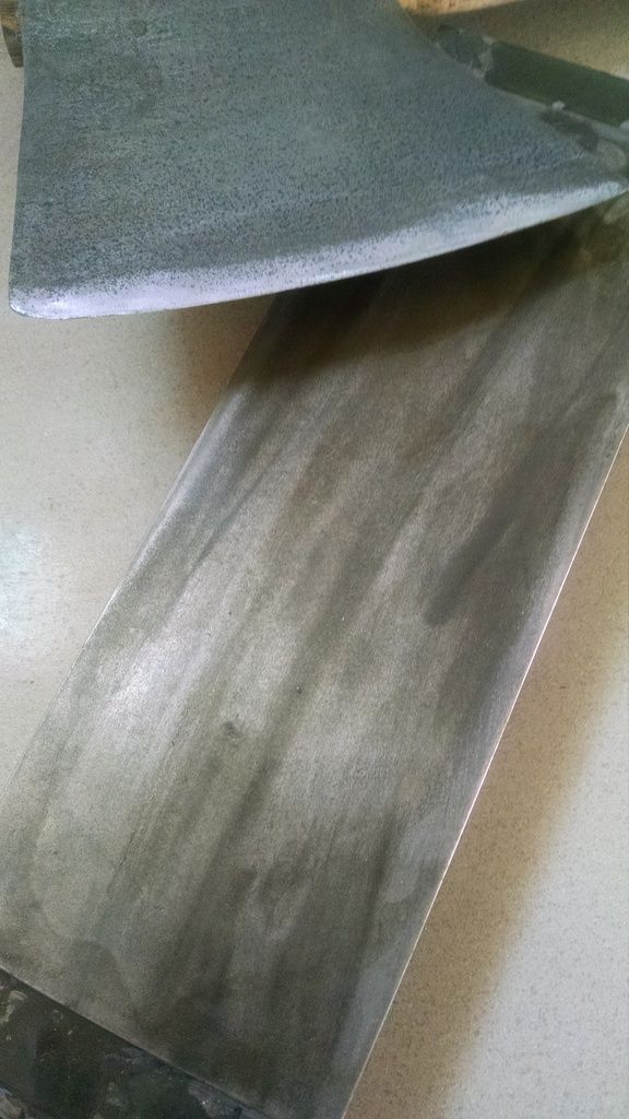

Hi guys!
Once again I must ask the experts.
I am a bit confused in this moment.
I had to reprofile a Roughneck Mini Mattock. It came with very very obtuse angle, and I wanted to make it MUCH thinner, so that it would cut roots much easier.
I had read that even with very coarse Waterstones or with a Spyderco Sharpmaker with CBN rods one needs half an hours to change the angle of a S110V Manix 2 knife (which is just 2,5mm thick), so I thought it would have been extremely slow (if possible at all) doing that with my Mini Mattock.
But I did not want to use a machine like a Flex or so, because of the risk that when the angle becomes thin enough the metal can become too hot and the Hardening gets lost.
So, I thought that a File could be a good idea.
I thought so, because a File has got much much coarser "grit" than a, for example, 120 Grit Diamond Sharpener.
I also thought that the only reason why Diamond and CBN and Ceramic and Silicium blabla sharpeners can bite a hardened steel, is because they are harder.
So I thought that if I could find a File which is harder enough than my hardened steel Tools, I could do the job with it.
So I have bought a File from Dick, a "famous" German producer.
It was written "specially for Steel".
Well, the File did not do the job, on a 8cr14mov 58HRC Sanrenmu VERY cheep blade.
So I did not even try it on the Mattock (where the material to file away is MUCH more).
Somebody then said to me, that it is NOT possible to file a hardened Steel, no matter which File you use and how hard it is.
It was also said to me that when one buys a File and he reads "specially for Steel" it is ALWAYS meant "normal not hardened Steel", because it is somehow a sort of convention in this field, that when one speaks of Tools and says "Steel" without specifying if hardened or not, then it ALWAYS means strictly "not hardened".
And for this reason, a File advertised as "special for Steel" it is always only for "not hardened Steel" and I should supposedly know it.
So, my questions would be:
1) is it true that it is internationally known that when one speaks of tools and Files and he says just "Steel" it is ALWAYS meant "not hardened steel"? Or would you under "special for Steel" also, like me, understand "for all Steels, hardened or not"?
2) can a File, if hard enough, bite a hardened Steel so to be used for reprofiling? If yes, which material should be the File made of, and how hard should it be? For example, I have seen Files of Vallorbe, called Valtitan, which are coated in Titan, and are 72HRC hard. I would use them on 58-62HRC hard Steel. Would that make sense?
3) IF I can use a File, and if my aim is to use it just to take as much material I can and than finishing the job with a CBN or Diamond or Ceramic sharpener, how fine/coarse should the "grit" of the File be? For example, I had understood that with a Diamond sharpener one must choose a coarser grit for reprofiling (something around 120 or 200). But I have read about Files that the harder a material is, so finer must the grit of the file be.
And I just can not understand this.
4) what would YOU use to make the reprofiling as fast as possible, if you would not have to use any machine? And why would you not use a file, not even for the first part of the job?

Imagine, 2cm thick blade, 5mm long (yeah, just a mini mattock). 45° or more.
I have to bring it to 30 at least.
This means, I have to go down 3mm, on each side, on heardened steel, in a surface of 1-2cm x 5cm.
Can you really do that with a DMT X Coarse?
If yes, I should be ok with the Lansky 120.
I thought it was just impossible.
Or, veeeeeeeeeeeeery slow.
(Still wanting to know about files, from who has experience with them.)

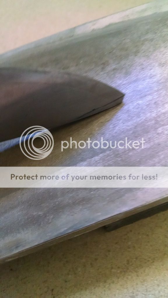

Now I did it with a flex with abrasive paper disc. It worked. I burned a bit the tip.
What should I do if I see that the edge gets damaged easily now? saw a few mm away to eliminate the de-hardened part (IF it was hardened) and grind again with stone/diamond?

Yes, I have noticed the water boiling. I did not water constantly, because I did not think about it, but as soon as the metal suddenly changed colour I stopped and poured some water onto the mattock. Vapour in one sec. I had to submerge the mattock in water for some secs...

I picked up a Shapton Glass 120 recently and it seems to work very well and produce very little mud. That's a big plus because very muddy coarse stones can scuff the side of the blade. It's a very fast stone but also very hard so lapping can be tougher. The best way would the Shapton puck and lapping powder or another coarse stone.
On the cheaper side you have the Naniwa or Suehiro stone like you were recommended. These will be short lived stones that dish quickly so buy two of them, after use rub them together to fatten. Check out fine-tools dot com.
On the very cheap side you have the basic Aluminum oxide or silicon carbide oil stones, these can be very fast and would probably work very well for what you want.
I think it's important to remember that this gentleman is not talking about a knife, especially a nice knife. He's wanting to thin down a mattock. (digging tool)
There is just NO WAY that I would recommend a file for that job. I don't care how expensive or well marketed or how hard the file is.....there are much better alternatives for this job. I use files to cut my bevels on my knives exclusively. The Pferd Chipbreaker is probably the most aggressive file I know of.....they're about $35 plus shipping. I use them all the time and there is no way I am putting one to hardened steel. You mentioned you didn't want to use a machine because you might ruin the temper. Look, if this were a knife, especially a nice one, especially one that is very hard with thin geometry, then over heating the edge with a power tool would definitely be a concern. But you're talking about a mattock. Likely mild carbon steel that isn't very hard to begin with, that has lots of mass to it. I would have ZERO issues using powered equipment on such a tool! It's not like it's a $500 kitchen slicer.
If it were me, and for some reason I had to thin a mattock (without powered equipment of some kind), I'd take my previous advice and the advice just given by Jason.....go to the hardware store and fine a cheapo SiC sharpening stone. Above that, Smith makes some relatively cheap diamond stones. You said you had a 120 grit Lansky? Have you tried that yet? There is just no way I'm 1. not using powered equipment on such a job and 2. paying money for a top quality file only to have maybe half it's life (if not all of it) trashed because I wanted to thin a mattock. Especially when a cheap SiC stone will do the job probably much faster and much cheaper than a file.
I guess I'll be one of the few advocating the use of files for this job, and for most jobs on low RC steel tools intended for hard use. I use files for setting bevels on my machetes, lawnmower blades, hatchets and axes, digging tools. I'd recommend cleaning any dirt off the tool first, and then firmly clamping the tool to a solid surface. Once the file begins to catch, it removes steel very quickly and cleanly and with a lot of control. Even with a coarse belt grinder, I'm not sure I'd want to put the wear and tear on it for a job like the one described when it can be easily done with a file.
The combination stones will be slow going by comparison. I wouldn't even use my 80 grit boat stone for a job like this, a 12" mill bastard will make short work of it.
