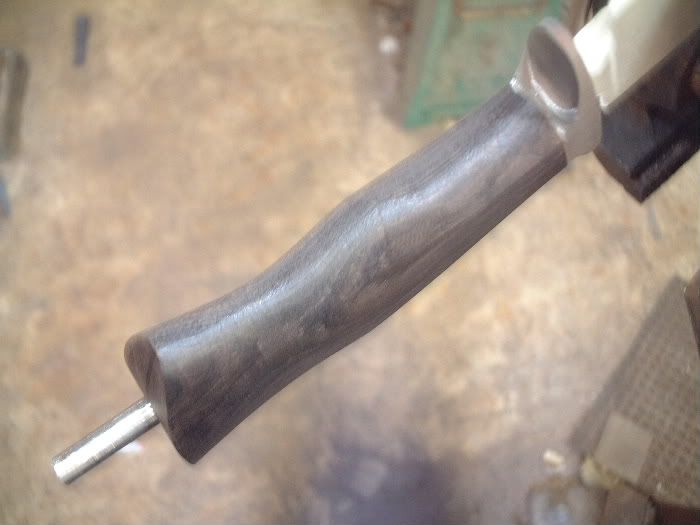

One of the biggest problems I see in knife making is trying to avoid the obvious pitfalls of all the grinding going on in shops - breathing protection, dust collection, etc., especially when it comes to handle materials. (Not to mention the unnecessary costs of belts)
My first advice is to quit grinding and making all that dust in the first place.
Use files and rasps and all the big chunks just fall on the floor and never become airborne in the first place.
Seems like a no-brainer to me.
Here is the floor right below where I just got done filing an African Blackwood handle to shape with rasps and files.
NONE of this went up into the air in the first place.
And I file stag, ivory, Micarta, G-10, wood, etc.
It might pay to re-think how some things are done.
If they cause problems - there might be a better solution.
I realize not all knife making situations can be handled with files, but the $$ I've saved over the years from not needing to buy grinding belts for handles has been rather profound.
Not to mention not having a shop filled with dust.
Or my lungs.

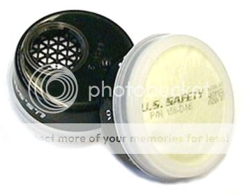

I use the resp-o-rator along with a dust evacuation system that is a semi-closed loop in my grinder shroud. I am also currently working on an upgrade for the breather to use 3M filters.

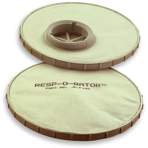

How does the filter attach to the respirator? Does anyone have a picture of the attachment points? I'd really appreciate it.
Does it look like either one of these:

I can't use a regular respirator due to my beard.
From the looks of the above filters, you can use P100 filters with the Resp-O-Rator.
I just realized that I gave the filter number but left out the fact that I am using the resp-o-rator JR
Here are some measurements. I haven't found any compatible filters. Which is why I intend to modify/replace the mounting bracket.

IMO yes. Especially if you have a big beard. I've been using !one for a few weeks now and it works a lot better than the half face ones. You can also get p100 filters(from the company linked above) and they're pretty much the standard for knifemaking.
