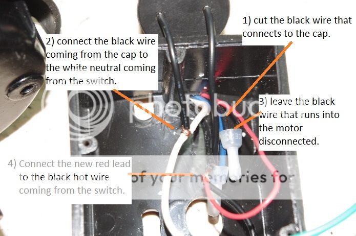

I successfully worked through these excellent instructions with my new 1x30 sander from Harbor Freight.
Here are some annotated photos:
thanks
James B

My first attempt to post. I was looking for a good way to sharpen my hunting knifes and ended up with this thread. Decided to reverse the direction of the grinder as in this thread, but instead mounted it on it's back and made 3 rests 18deg, 20deg, and 22,5 degrees. Use 600, 1000 and leather belts - results are amazing.
Edit - the pictures did not post - anyway mounting the grinder on it's back reverses the direction of rotation and the belt is moving away from you at a 45 deg angle. I will figure out how to post pictures.
This is my first attempt to post. What colored wire goes to what terminal on the DPDT switch? And which is the start winding wire for sure ? (Cut which lead wire off the white wire, it has 3 wires) ?
Hi, I think the person who posted the photos just reversed the direction and did not wire in a DPDT switch is my guess. Basically what you are doing is installing a separate neutral wire for the start winding and then you can reverse the blue (start winding hot) and the new neutral (red in this case) and reverse the motion of the wire. I am starting to work on doing the same thing. My motor does not seem to have 3 wires attached to the white neutral ... I only have two. So I plan to cut one and solder a new wire to it. I am not sure which is the neutral of the start winding or the run winding so I will probably have to check resistance and see and either the existing white will be my start winding neutral or the new wire I solder (assuming I cut the right one).
Disclaimer: I am no expert on this stuff, just read this thread and also watched some youtube videos so take my comments at your own risk!
You can see the two black wires going into the sheath with the blue stripes and the white goes into the one with the red strip. There are two wires exiting the red striped sheath. If anyone knows how to visually discern the start vs run wiring neutral please let me know.
