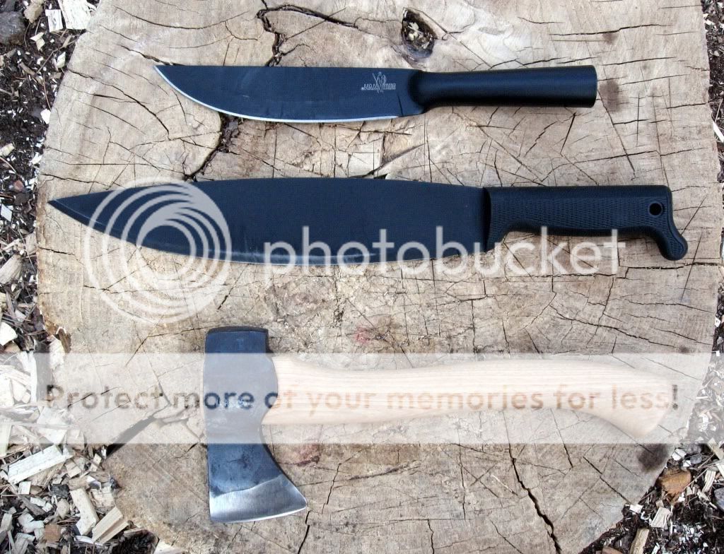

I already mentioned that the Barong was like a Bushman on steroids. Here's a size comparison between the two, with my Husqvarna\Wetterlings 1.25lb Hatchet thrown in to give a better idea of the size. As you can see, the Barong really looks more like a big honkin survival knife than a typical machete.

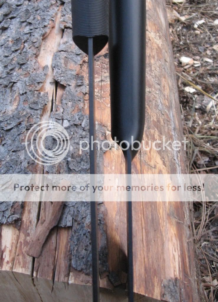

The Bushman and the Barong both have the same blade thickness as shown here:

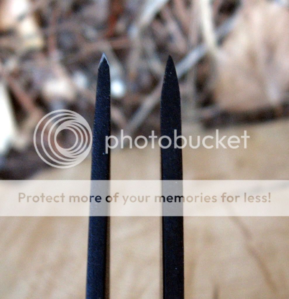

The tips of both blades (to the right is the Barong)

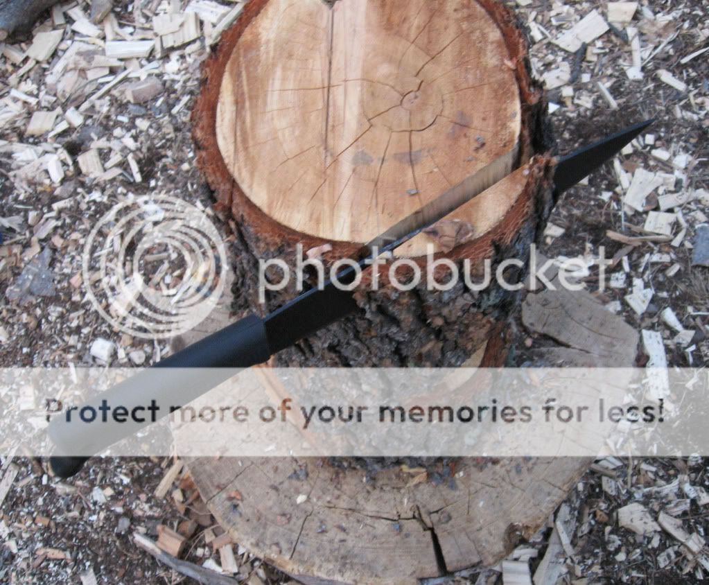

Now for the fun stuff- chopping and batoning. Though I consider myself more of an axe person, tools like these can be used for batoning if the situation calls for it. That said, they should be able to handle these tasks easily without breaking. The Bushman has been put to the test already by thousands of users as well as the Noss guy on Youtube, so I won't rehash any of that here. What I did want to find out was how well the bigger Barong would fare against the Bushman in chopping and batoning and if the extra weight would be worth it.
For demonstration purposes, I grabbed a big 9 inch seasoned and knotted up Douglas Fir log, pretty much a nightmare to split even with a big axe. I know the selection of this kind of log may seem extreme, but I've been in situations before where I camped or hiked in more well used places and the only firewood around has been bigger pieces like this. The Bushman's 7" blade is simply out of its league on a piece like this and could only be used to take off very small pieces from the outer edge, realistically. Note that even at the edge, there is very little metal to strike with a baton

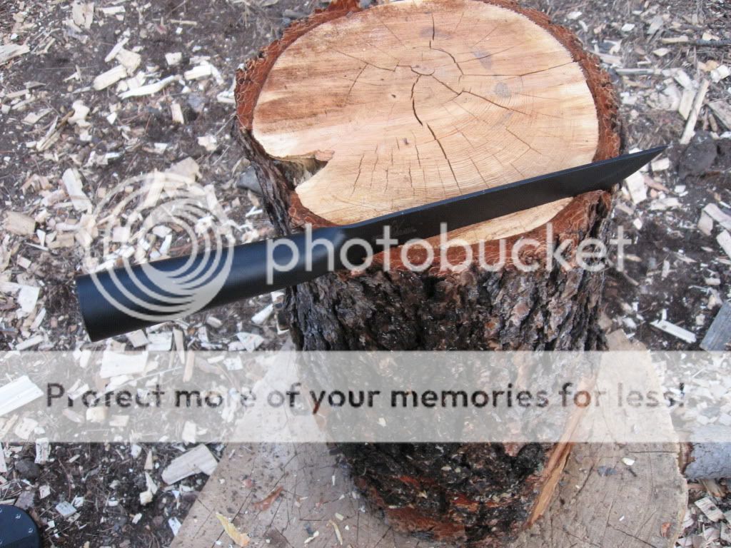

I didn't baton this log with the Bushman, but wanted to show the difficulty it would have if one encountered a larger log.

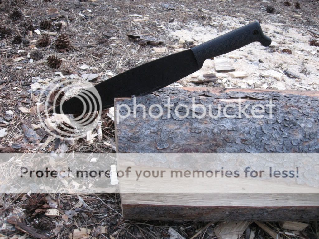

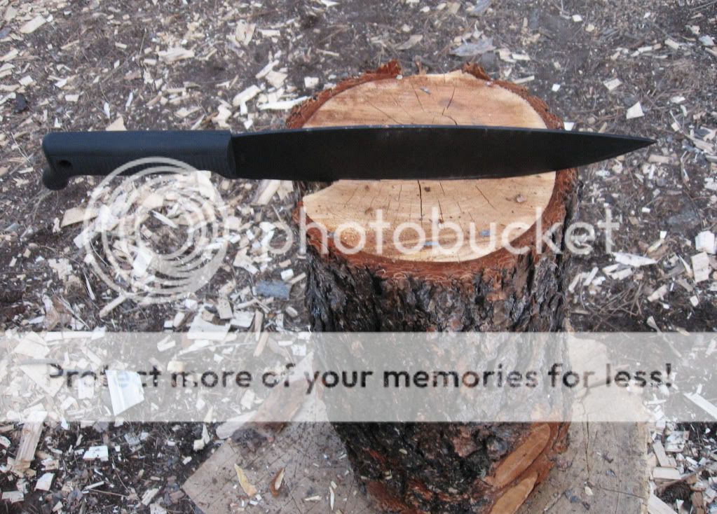

By comparison, the 12" Barong Machete dominates this log and has plenty of exposed metal on the back of the blade to baton with:

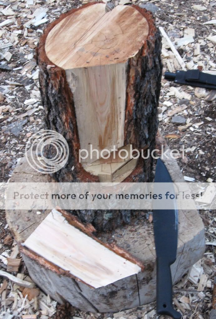

Though the Barong is pictured in the middle of the log, I would never attempt to baton through the middle as it would probably destroy this or any other blade since the knots are so bad in this one. I ended up taking a piece from it, which it handled easily......

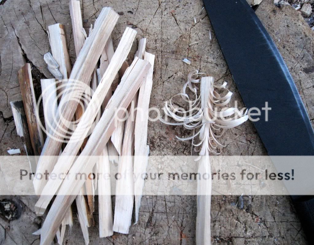

The Fir chunk was easily reduced into kindling with the Barong, and to demonstrate the cutting capabilities, created a featherstick with it.

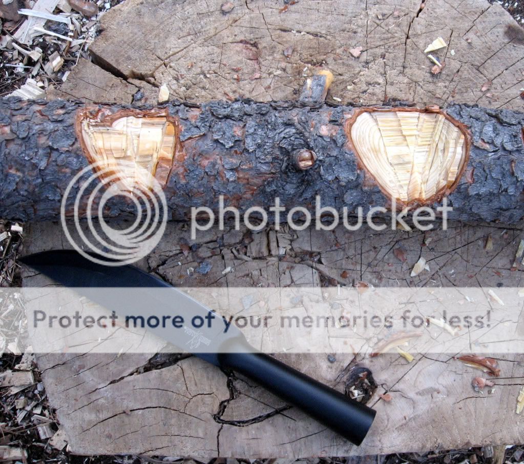

In a comparison to test chopping, a piece of partially seasoned Douglas Fir was used. On the left is the Bushman after 25 chops and on the right is Barong notch after 25 chops. Clearly, the Barong is a much more powerful chopper. The angle of the photo doesn't show the depth of the Barong chopping notch as well as I would have liked, but needless to say, the Barong chops almost 3 times better yet weighs only 7 ounces more than the Bushman.
My overall impression is that the Barong is about three times better in batoning and chopping for only a 7 ounce increase in weight over the Bushman. As evidenced by the featherstick in my photos it is also capable of some of the finer work that the 7" Bushman blade can do as well. I've found the combo of the Barong machete plus a Mora, Swiss Army Knife or Multi-tool along with a Coglan's 7" Sierra Saw to cover just about all bases.
