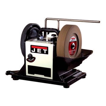

I purchased a Jet 708015 JSSG-10 Slow Speed Wet Sharpener last week. I sharpened one kitchen knife straight away, and pondered on the results for a week.
Today, I sharpened two pocket knives.
Verdict? Mixed feelings. Not ecstatic working with the water mess. However the water does capture the filings, and cool the blade.
Results are pretty good, for kitchen knives. Gets blades very sharp. It does not leave an edge that would impress a picky person, looking for exacting details, like you get with some jig sharpeners.
Speed? Fastest system I have used yet. Several (8) passes on the wheels, and you are done. Does degrees from 10% a side, to infinity.
Built in leather wheel strop. Gives a mirror shine. (4 of the passes)
Cost? $315 from Amazon. Free delivery, 2 days, with amazon prime.
Hacks I have learned so far? Sharpen with the wheel spinning away from you.
The system is set up to sharpen with the wheel cutting into the knife edge. Doing I this way is very aggressive, and de not give as clean a bevel.
It is a simple mater of using the jig arm on the front of the machine.
I will be sing this sharpener to work Gnn shows .
Final thoughts, worth the money, if you want sharp knives and other tools, fast.
http://www.amazon.com/gp/product/B000LE22EM/ref=oh_details_o03_s00_i00?ie=UTF8&psc=1
I forgot to mention, if you want a primary and secondary edge, that can be easily done by using two support arms, front and back. One arm can be the primary, and the other arm can be the secondary.
