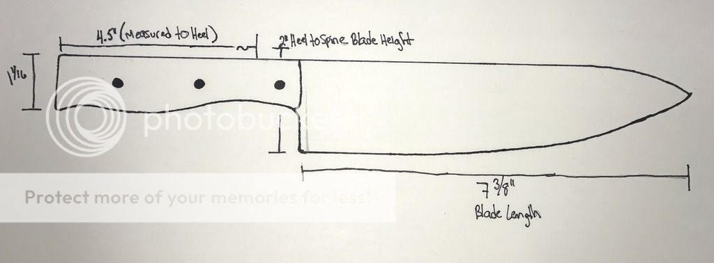

First attempt at roughly 8" chef knife. I am many things, an artist isn't one of them so please excuse the drawing, but measurements were taken afterwards when a couple proportions didn't look right on rough draft.
I will most likely end up on 1/8" steel with a simple flat grind, or if I get thinner steel maybe a scandi-ish grind.
PS. I know pins are not centered will adjust
