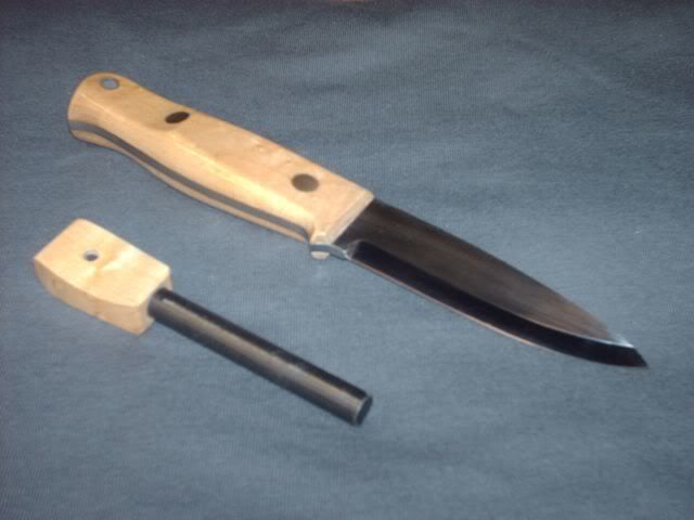

The knife kit came to me roughly one month after ordering it. This is very reasonable considering knives are made as orders are filled and the shipping was international from Great Britain to the United States. Steve included all the components of the kit and an extra chunk of hardwood to make a matching fire steel handle. I opted for different handle bolts and tubing and ordered solid brass from Texas Knifemaking Supplies. There is nothing wrong with what Steve sent, I just got a bit picky and wanted something different. The kit was carefully packaged and arrived unharmed.

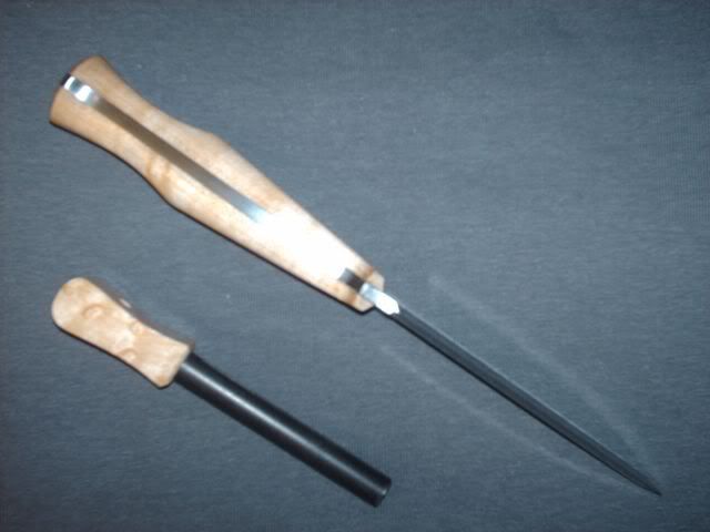

At first glance, the knife kit appeared to be of the utmost quality. There were no marks from tooling and the knife resembled a functional work of art. The birdseye maple was very good quality with beautiful grain and I eagerly contemplated the finished knife before it was even assembled.
I brought the knife kit to a friend of mine who has worked in the custom grip making industry for some time now. Greg Haugh of Lone Rider Custom Grips, a supplier to JoJos Gunworks, has made custom Single Action Army and 1911 grips for extremely high end firearms. He has made a set of Black Micarta grips for my Smith and Wesson 66 and completed a Fallkniven blank into a finished knife on previous occasions. Given his experience and skill, I knew he could create the correct handle contours for this knife and make it resemble what I wanted in my version of the Ray Mears Woodlore style knife. He also would contour the extra slab of birdseye maple to the fire steel rod I provided him. Needless to say, he took on the task at hand and got the job done.

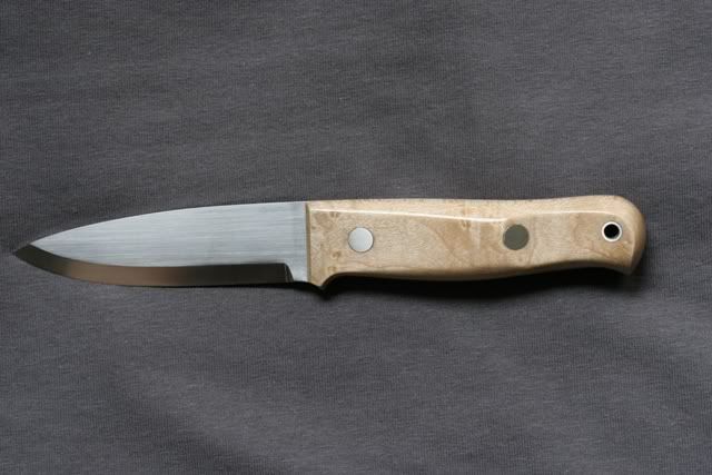

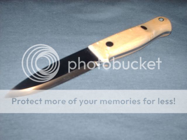

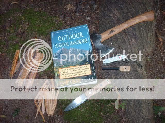

The finished knife balances nicely in the hand. The generous palm swell locks the knife handle into your hand and provides for a very secure grip. Mears describes the ideal handle as having a Shaped grip so that you can feel the edge side and avoid your finger slipping on to it in the dark; a guard is an encumbrance. This knife has these attributes for sure. The Birdseye maple wears like iron and is incredibly hard and dense. The knife was used for slicing, carving and battoning so far. I took a large chunk of fatwood and made smaller and smaller pieces with ease. In all of these tasks, the knife performed well and presented me no cause for concern. Mears describes his ideal knife as having a blade wide enough to be grasped forward of the grip. In very fine carving, this knife allows for this hand position and excels at its job. It is well-built and designed to be a user.
