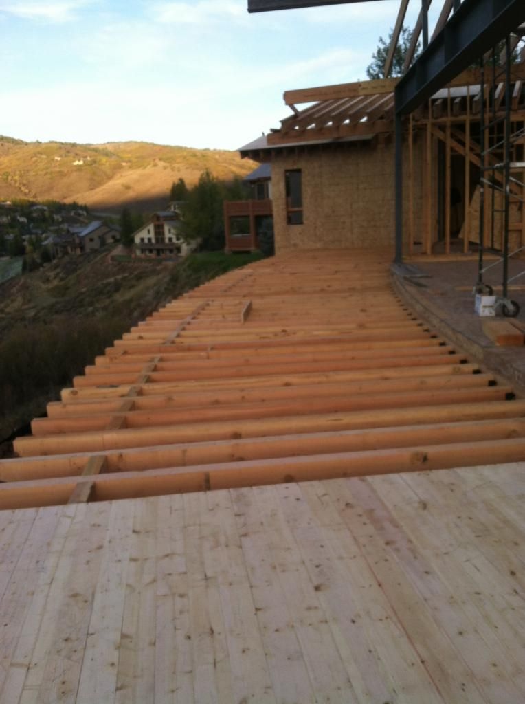

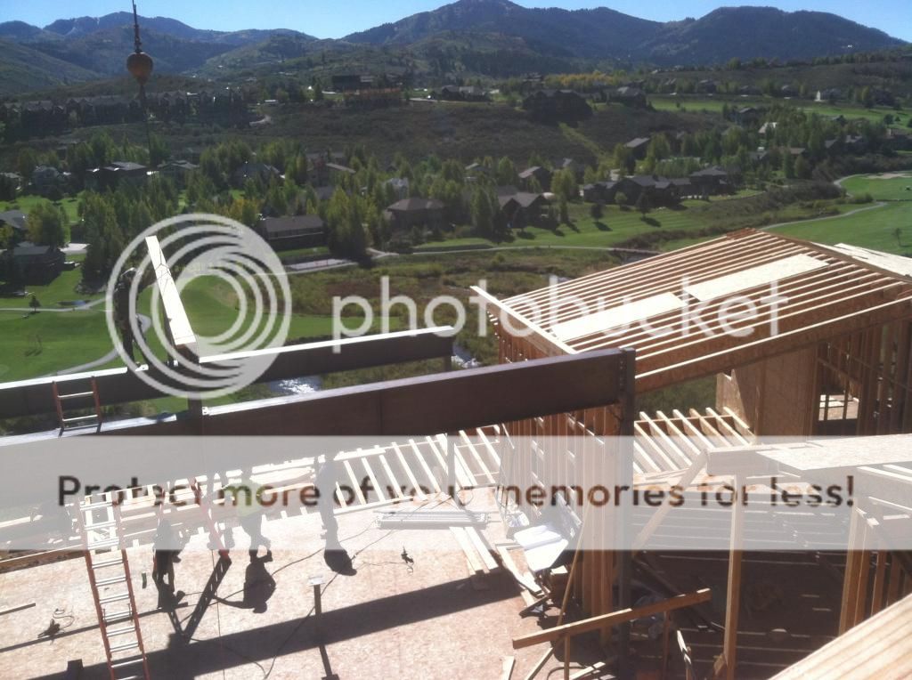

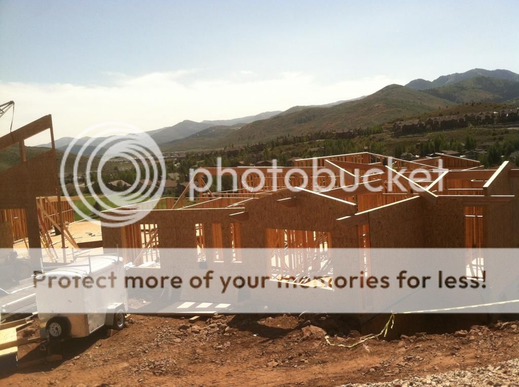

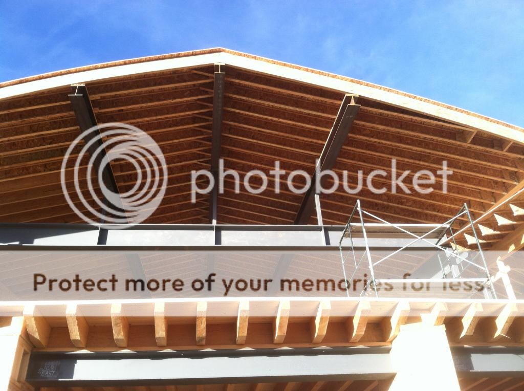

these are the types of rigs I build with my rigbuilders hatchet
You can bet those guys standing around leaning on ladders don't work for me
