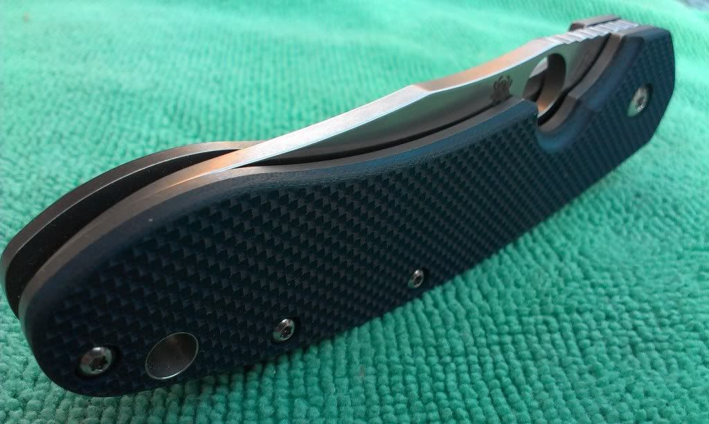

I dyed my scales on my 300sn. I used navy blue and boiled water, put the whole pack in, and let it sit in a bowl for 15-20 mins. Came out looking super dark brown.. was hoping for blue, but I kinda like it tho
Keep in mind, folks, that whatever color the scales start as will affect the color of your dye job. If your scales are yellow G10, you won't get blue if you dye them blue. If your scales are brown, you'll get a muddy blue-ish brownish color. The kind of G10 may also have some effect on the color and dying time. I have to wonder if peel-ply G10 takes dye better than some others. The denser the material, the longer it will take.

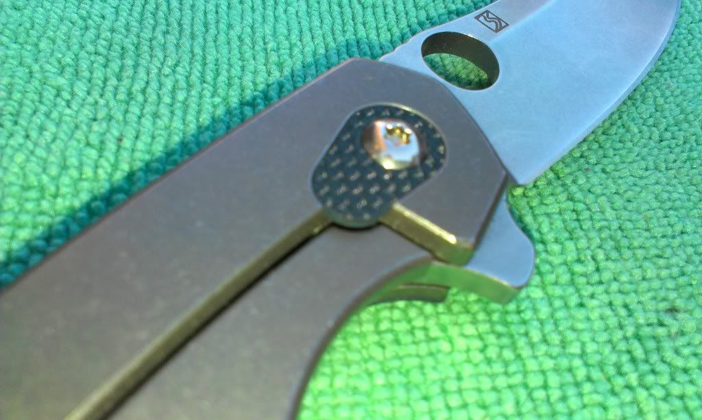

Here is the result of using Cherry Red dye on grey/black G10. You'll notice that it didn't turn out cherry red...
Bottled green. Its a light green. Kelly maybe? I can check later.
Little vinegar, 3/4 bottle, about 4 cups of water. Boiled for about a half hour.
I love it!
Edit - yes Kelly green. I suggest a light blue. If it doesn't come out dark enough you can try darker. Also, you can try mixing. I considered Denim blue, but I'm very happy with my results.

I used a whole box of denim blue to do my Southard. Used about 4 cups of water,simmered for 15 min or so came out great!
