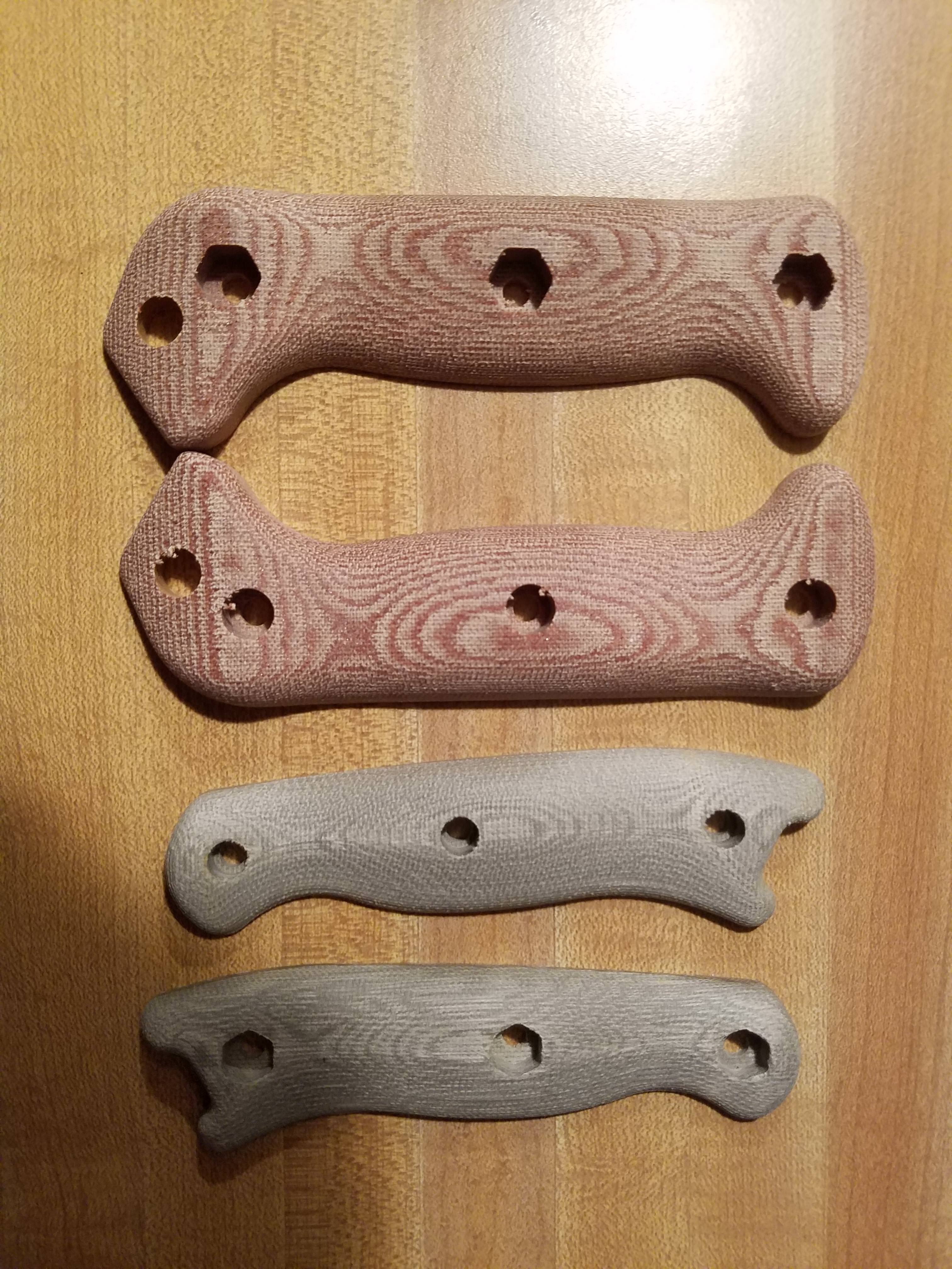

Having a couple of BKs sitting without scales (because I hadn't gotten around to re-dressing them), and having seen countless posts of dyed micarta, I decided it was time for me to give it a whirl. Step one - order micarta scales - Done...but wtf is this??
The full size scales look like natural micarta. Never gotten that before. I don't particularly care for that color; but I was planning on dying them anyway, so it wouldn't matter.

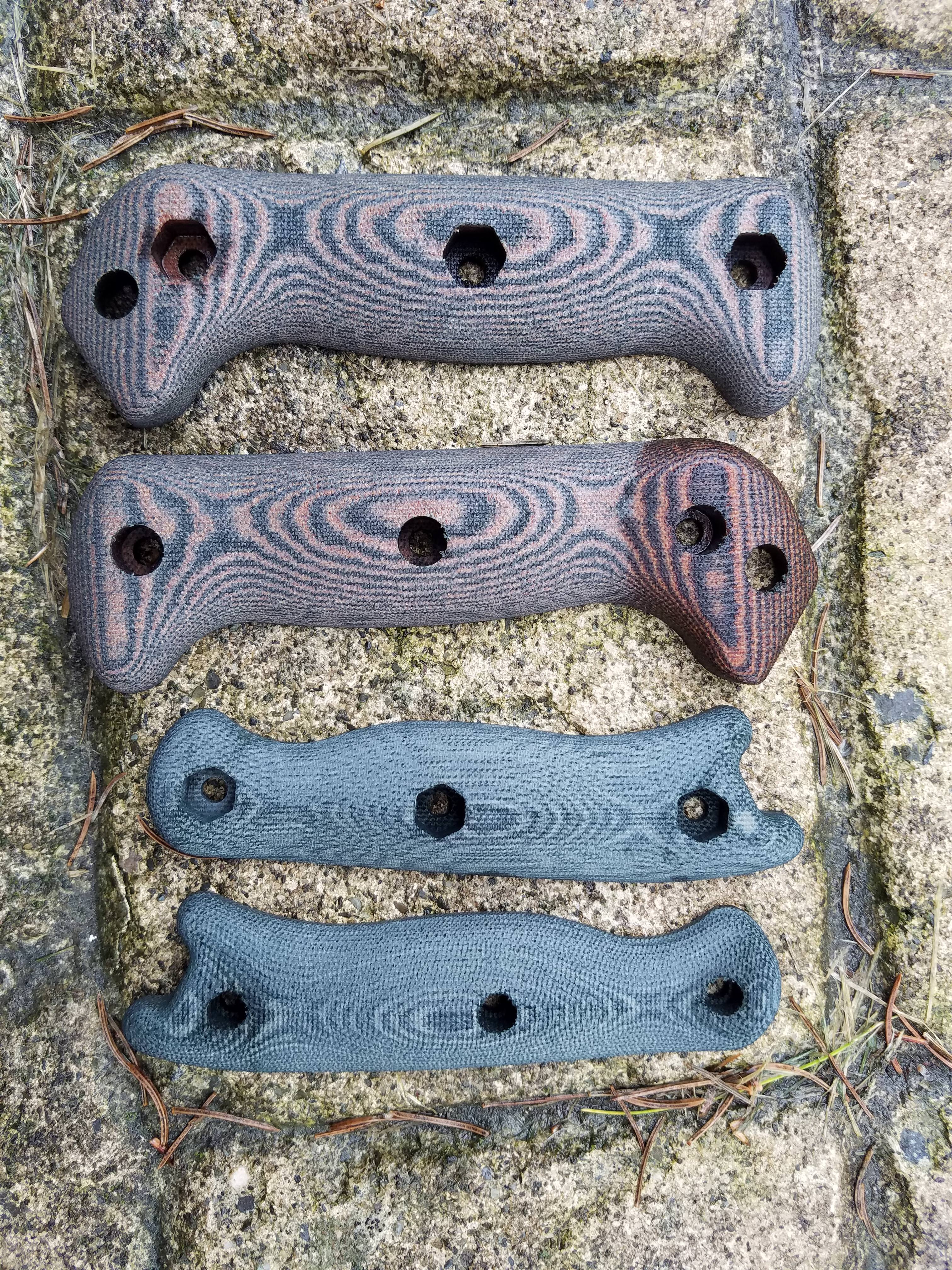

I decided on green; but figured that Dark Green would be darker than I wanted, so I grabbed some Pearl Grey to mix with it. I filled a big ol' pot with hot water, added a dash of dish soap and some sea salt, then dropped in the scales. Using my scientific eye, I measured/poured appropriate amounts of each color into the water. I stirred and stirred, then put the pot over low heat. Barely 10 minutes later, the tweeter scales looked good... and the full sized scales didn't look much different than when I'd started. I gave them a few more minutes, then pulled the tweezers out of dye bath and added more dye (hoping that would help with the remaining scales). By the 40 minute mark, I was still unhappy; so I added even more dye...and the now nearly dry tweezer scales were just a little lighter than I wanted; so I dumped them back in for 5 minutes. I let the full sized scales go another half hour after I removed the tweezers (with the rest of the bottle of dye added!!), and - well - I'll let the picture do the talking.
They are still damp; but it's pretty obvious that the full sized scales did not like the dye. The tweeners ended up getting darker than I wanted during their second dip (due in part to the added dye); but I can live with that. The other set, though, just plain sucks - I'm probably not even going to bother trying to dye them black.

Thank you, all, for the comments & advice. I pulled them out of their second dye bath about 2 hrs ago, and they're better... I'll decide when I've seen them in better light if I'm going to put them on a knife.

If you're referring to the BEFORE picture, I don't believe I've ever received natural micarta BK scales - as mentioned, I'm not a fan of natural micarta; so I wouldn't have bought more of them (and I've got micarta on just about all of my Cam BKs). Admittedly, I haven't bought them recently; so maybe they've changed - and you started - since my last purchase. I'll post a picture of my other's later, for comparison (truthfully, as certain as I am that these are different, I am compelled to check to make sure I'm not mistaken).
I'll take pics of the re-dyed scales, as well.
ok, they aren't as green as I remembered; but they're not nearly as tan as the new ones, either. I should have thought to take a side by side before dyeing

I think the big ones did take the dye. Unfortunately for you the epoxy layers are red instead of a neutral color, so that didn't change. I don't think you can fix that as the epoxy isn't permeable.
They do look better than when you started though. I wish someone would offer different color micartas and other materials for lots of mfg knives.
