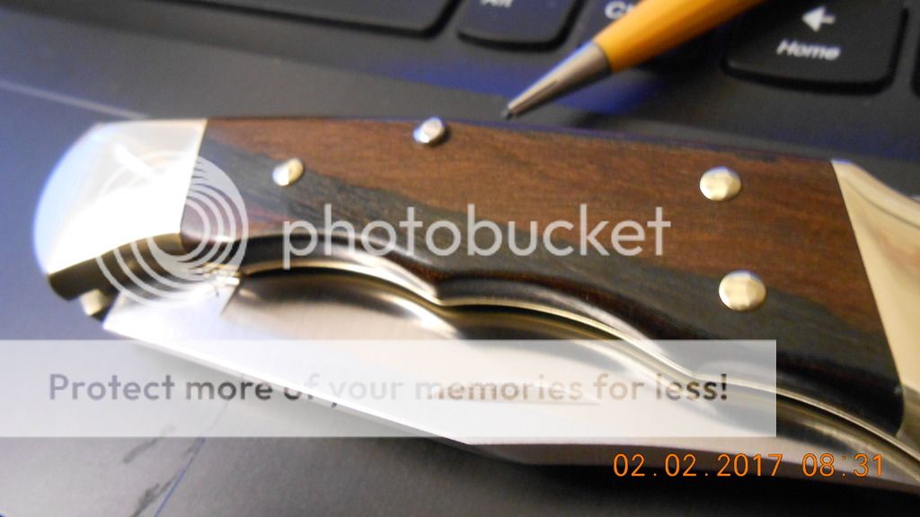

A bit surprised on what is probably a simple QC issue. I just received a new Buck 112 today. One of the rivets is not inserted all the way, and I'm wondering how to get this fixed? All others are close to flush against the handle, but this one is easily noticeable both by sight and touch. Is this something that anyone can fix? Tools needed? New rivet required? Or does it need to head back to the shop for repair?
TIA -- Appreciate your suggestions.
Bozhidar
Is this your first 112? Which rivet is it? The rocker rivet, center near top has a larger, more rounded profile and is supposed to sit above the handle material. Really need a photo.

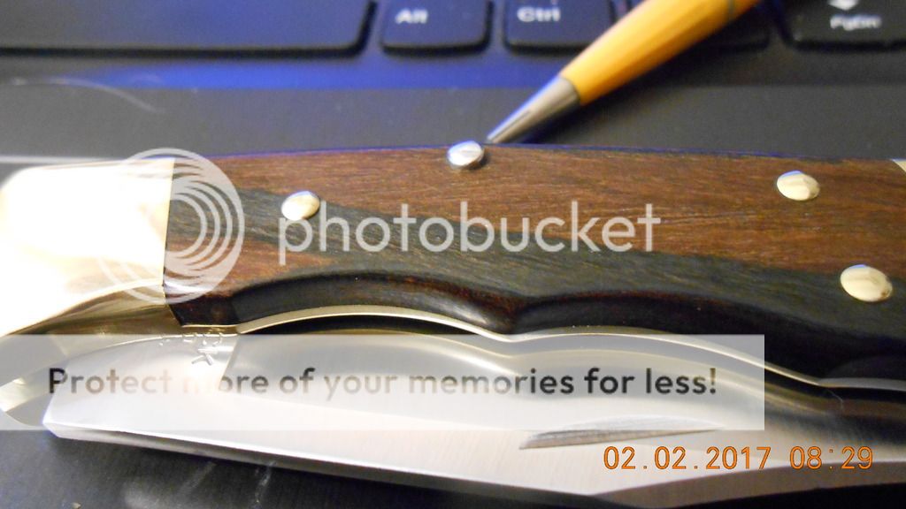

Yes, this is my first 112. Based on what you said, the rogue may be the rocker rivet. I didn't know any of the rivets were named. Here are a couple of photos....hope they are clear enough.
Bad QC for sure. Mine are all flush and look the same. I would send back. Should be fixed by them. The wood is easily damaged. This is of course if you care about damages? Good Luck.
boz, that is the rocker rivet. Some do set a little proud. I can see your's seems high. Still, it looks to be touching the handles and holding them on. If it bothers you, you can carefully sand the top down or return it. It is a finger groove, nickel frame and the wood looks nice. Is it from the custom shop? DM

Back to square one with some Qs for you, Badhammer. You said the rocker rivet "is supposed to sit above the handle material." Does my photo identify that position correctly then? And curious as to why is should be at that higher position?

Thanks for the photos Boz. I would agree that rivet is a little too high. Perhaps it wasn't rounded over completely. If it's tight with no gap then it's doing its job. From a purely cosmetic standpoint it does look a bit off. It shouldn't effect function and if it were mine and one I intended to use I wouldn't give it a second thought. I thought it might be your first 112 since the rivets aren't flat like other designs and I thought you might be looking at the rocker rivet and thinking it should be flat when it isn't. That being said yours is not the norm.

Well, made up my mind on what to do with this rogue rivet. Although it is slightly high and slighty angled, it appears to be holding the handle okay. There is no looseness with either the handle or rivet. So I'm going to stay with this 112 this time. The wood handles look very nice, so that would not be easy to send back for a replacement. Wood is my favorite component for knife handles and rifle stocks, too. I consider the wood to be works of art. So this 112 is a member of my collection now. :D

The spring rocker rivet is the one that is too high, it's purpose is to hold the center spring in place and to let it pivot, so there is some degree (thousandths) of space so the spring can move freely up and down. the same with the opposite side rivet. The other three rivets hold the handle sides which are called scales onto the frame of the knife. Hammering the rivet down is not advised because the space will tighten the rocker spring and it may bind. It needs to be replaced or left alone or sanded from the top. Taping the knife before sanding will keep it clean and done slowly will not loosen the scales and hopefully not touch the wood. I'm talking about not sanding by hand but using a belt sander carefully.

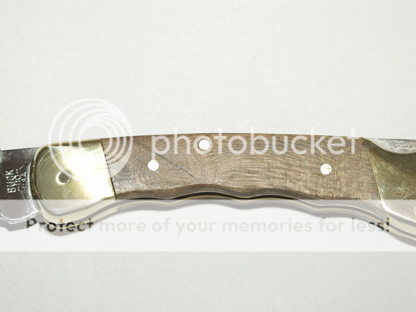

This Buck 110 has the rocker rivet (center rivet) flush with the scales and 2 scale rivets on each side. This is how this knive was made.
The silver piece down the center of the spine of the knife is the spring which pivots on the rocker rivet when you push down on the rear to unlock the blade.
