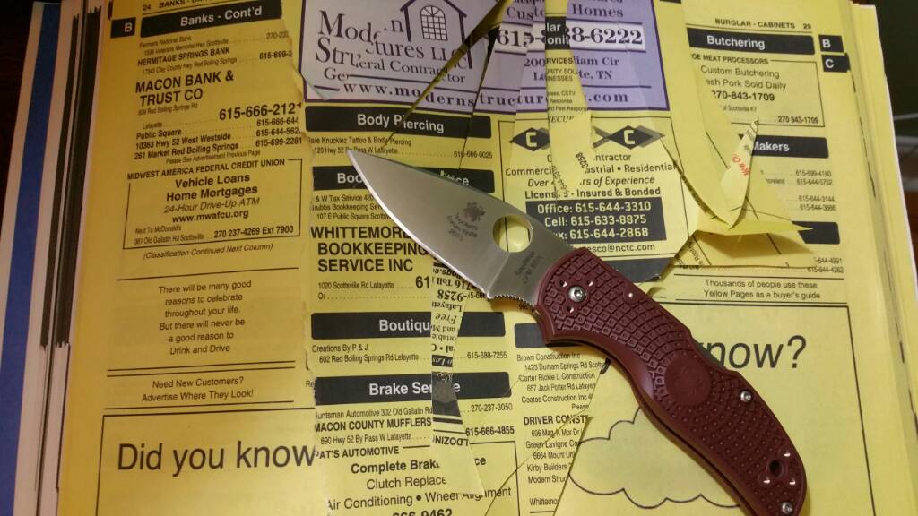

I noticed I never carried my s110v manix because i was afraid of how brittle it might be so I decided to test it, That turned into testing the 3 steels until significant damage. It was not meant to be a ranking, scientific or so forth, It was simply to establish what these steels would tolerate at common angles and what they wouldn't. Real life is is not carefully controlled so I did not attempt to do so with my test. I know you guys hate hard use tests, but maybe someone will find it interesting. I started carving/hacking some chunks out of a old 2x4, might have been pressure treated not sure. I didn't do a lot of carving, But I was rough, and often hacked at it. I wasn't testing the knives as wood working tools just seeing if they would withstand the occasional use. Next I moved onto some very thick wire, then I sliced into a pie tin. and finally I chopped into a piece of steel high tensile wire. After that I stabbed the tips into the aforementioned 2x4 and did some light prying.
The Paramilitary 2 was set at 32 degrees inclusive, the s90v forum native was set at 36 degrees inclusive, and the manix 2 had a roughly 28 degree backbevel to fix the terrible factory sharpening and then a significant microbevel at 36 degree inclusive. All were shaving sharp and sliced newspaper, although the edge finish was not identical.
All sharp

Interestingly enough all 3 knives, disregarding chips will still easily shave and slice newspaper, in fact the PM2 still easily push cuts it and the manix 2 appears to have absolutely no dulling on undamaged part. I didn't carve enough, nor cut anything that should wear it. But the fact itll still cut smoothly with damage, and the undamaged bits to take little to no dulling from the pie plate was impressive.
