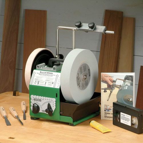

No. Actually I used a knife attachment for a Tormek sharpening system I own for sharpenming plane irons and chisels. It's a slow rpm, water lubricting system that allows course and fine sharpening along with a leather wheel for the final edge. It takes less than ten minutes to get a really sharp edge. I've also used it to re-establish the point on a BG-42 110 blade that I used and broke about 1/16 inch of the tip off of. It now has a nice point, just like new.

The cost is $395. Remember, I bought it originally to keep my woodworking plane irons and chisels sharp, so I just bought a small knife jig to go along with it. The knife jig allows for a consistent blade angle, depending on the end use. You can see in the picture the angle guide that allows you to set the jig at the correct angle to the wheel. The price of the knife jig was about $30, so it was an easy choice for me.I gotta ask, is it comparativly priced with a Lansky? :foot:![]()
