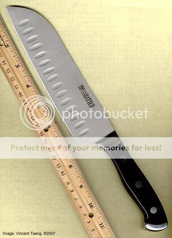

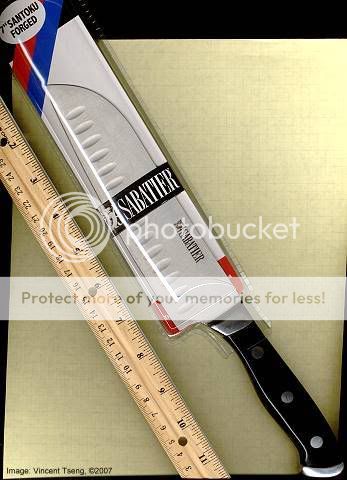

Santokus are very fashionable, as ConsumerSearch.com in their survey review of Kitchen Knives says -
"Santoku knife. While sales of traditional knives are stagnant, popularity of santoku knives have tripled. Both chefs and enthusiasts extol the virtues of this knife style."
So, one of the most vaulted names in kitchen cutlery - Sabatier - making a Forged Santoku is worth looking at.

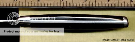

The knife has good heft and was well balanced. One feels confidence with it in hand.

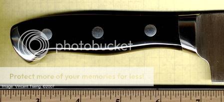

It is triple rivetted and the handle is of integral bolster and end cap design, fits my hand well -
It was pretty sharp right out of the package - but I found one side's angle was pretty obtuse - so I had to work at the bevel to cut in a more acute angle - and because of the way I use a (fine diamond) flat stone I ended up with a sort of convexed edge. Now it is real sharp and slices through paper like no body's business.
So I took it to the cutting board to slice and dice some veggies....
and this is when I found what was wrong with the knife -
it does NOT cut through things well - oh sure it is "sharp" - but there is not much control when cutting through things like onions.
Why? - the blade is f-ing thick behind the edge, possibly because of the fancy cutouts or Granton/kullen edge (for a "non-stick" face) -
so despite having sharpened the knife - it acts more like a cleaver (albeit with a razor sharp edge). So that was over an hour of sharpening wasted - unless I am willing to work a LOT harder to reduce the blade face thickness substantially behind the edge.
A shame what appears to be a great knife in almost all aspects - except for the one area where it really counts - the ability to cut properly.
So am I disappointed?
of course......
Upset?
not really....
Huh?
I didn't say anything about cost and where I got it -
$11.83 from WalMart -
a "Sabatier" made in China - I thought Sabatier was French.....
however that does NOT automatically make it rubbish, there are now LOTs of quality items made in China....
However it appears that "Lifetime Brands Inc." are using the vaulted "Sabatier" name.
