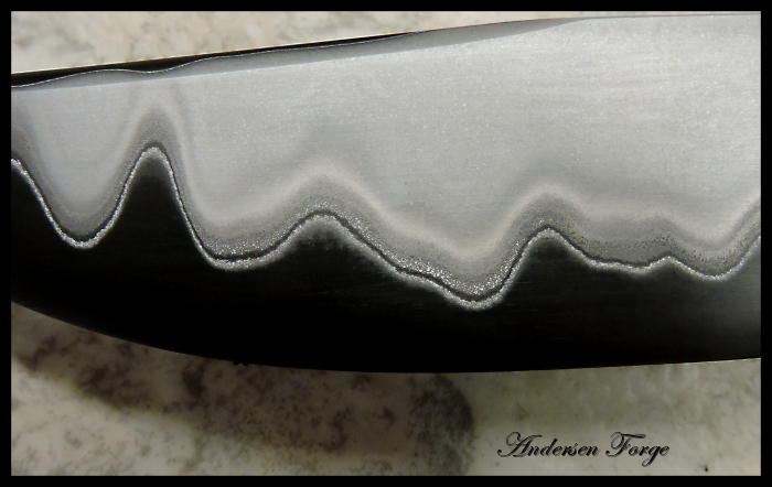

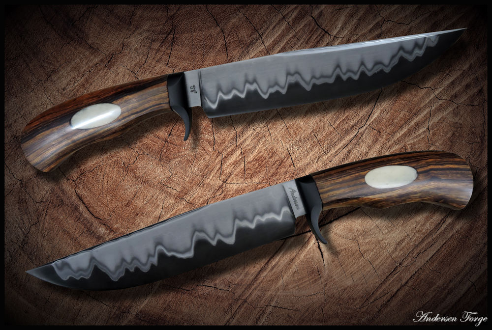

I'm a big fan of the appearance yet I make it for the properties of the core.
These are the old 1095FG that Aldo Bruno sold before the lift off of NJSB. It had a nice dab of manganese for the black and vanadium for.......well..........vanadium.

San-mai is a longtime favorite of mine and many other makers.
It has historically been used in many places and for over a thousand years. Japan, China, India, Scandinavia, Russia, Eastern Europe, and by blacksmiths in the early colonial US days.
It originally saved rare and highly valued high carbon steel by using less of it in a sword or knife.. Later it was a way to make a knife with varied attributes that would not be in the core steel alone ... particularly toughness against a catastrophic break in a weapon. It became a decorative method with suminagashi - damascus sided san-mai. As you have seen from people like Karl, it can be manipulated in forging to make amazing edge patterns. With all the variations, the main point is still a high quality core with different sides. In many cases the side material may cost more than the core, so it isn't just about saving money anymore.
One very useful attribute is it allows a cladding that would make a poor edge, like a damascus with nickel or copper layers. There are many stunning damascus patterns that while pretty don't make a very good knife. Add a core of W2 or a super steel with a compatible HT and it make not only a show winner, but a kitchen winner, too.
