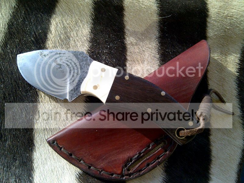

This was made from an old saw blade:
I love old saw blades....they make great shop wall decorations.
Most often they make poor knives.
What were the blades made to cut? Any markings? Photos would help.

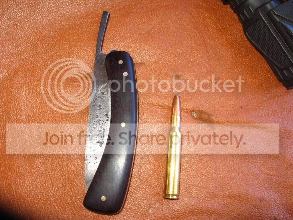

Some of them do, that is true, others not - but they are carbon steel blades after all. I have a big Friction Folder I made from an old saw blade some years ago and that I carry in a pouch on my belt and use often as EDC and for hunting, which means it often gets full of blood and while it will rust if left unattended, maintaining it is not such a big hassle at all - just wipe down well and keep it dry - and oil every so often when you get a chance - I just use Ballistol:
Next to a 30-06 round for scale:
And I can tell you that more often than not, come second or third day's hunting, the other guys with their store bought (and sometimes custom stainless) knives are looking at borrowing this one to gut out and skin their game, because it is the only one with a decent edge left.
