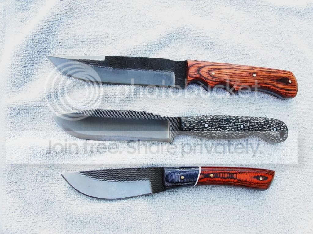

and btw lets see a full picture of your knife, I want to see how the bluing turned out!
Just noticed your request, but I didn't take a lot of pics of the Sawmill Cutlery knives, just enough to show the welded areas.
This pic shows the top Sawmill Cutlery knife (which had the apple cider vinegar treatment) and bottom (untreated) knife in full profile.
The middle knife is my customized Anza Boddington that I did a NEW post (link below) showing the customization, and recently also had an apple cider vinegar "blue" applied. ;)

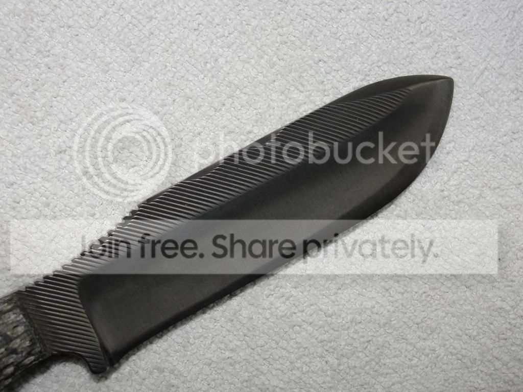

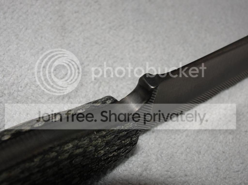

I took more detailed pics of the Boddington, and you can get a better idea of the finish arrived at. Pretty decent blue IMO, and easy to re-apply if needed with use. The Apple Cider Vinegar "blue" a pleasant surprise.
Clean up all exposed steel really well if you try this, for a more even finish. I used a quick steel wool brushing (0000 grade), followed by a sponge bath in dish detergent. Keep fingers off the steel after cleaning during the treatment. I warmed my vinegar in the microwave (to maybe 120 degrees or so, but no hotter than you can handle it so as not to degrade the epoxy), and thru the whole knife in the solution in a narrow tray. I agitated the tray from time to time, and kept an eye on the results. Took about 10 minutes to get what I wanted. A good rinse and dried with a paper towel, and coated briefly with oil and then wiped most of that off. DONE! :)
This was taken without flash in decent light, and pretty much shows the "look" in hand:
