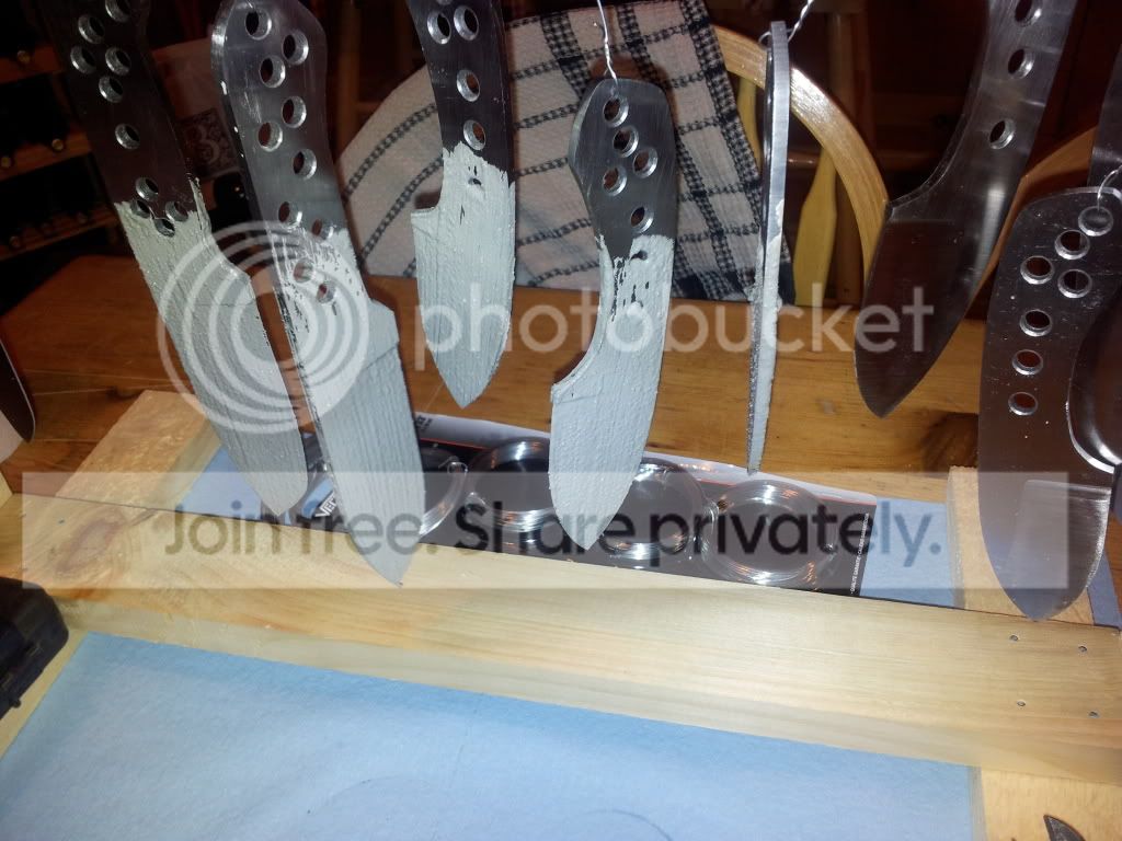

The key for me was figuring out that I didn't have to water it down as much I was. Applying thin layer doesn't necessarily mean using thinly mixed clay. I get it to the consistancy of toothpaste. The important part is mixing it up thoroughly, so there are no clumps.

does this look okay? I got the clay to "toothpaste" consistency. The small grains are part of the clay. Also I'm not sure what (if any) effect the lines will have. I painted it on with a small brush.
