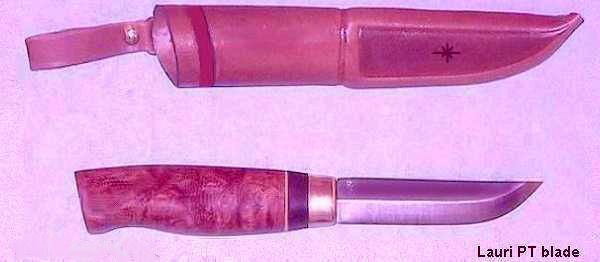

First, not a puukko. Looks more like a Gotland style Norwegian knife.
Marttiini makes Finnish style puukkot with a finger guard. The are also Saami style Leuku with finger guards. Look up Knivsmed Stromeng Samekniv 8.
Just for reference, a puukko looks like this -

While there are several puukko/leuku styles knives on the market, they are mainly for the western market. The Finns have a saying: " if you need a
guard on a knife, you shouldn't be using a knife". Some Finnish makers use a slight finger notch in the handle just above the blade. Those Arathol shows are good examples of main stream puukko.
I prefer a hook pommel; makes it easier to remove from sheath IMHO. (One I crafted). The Marttiini Olympian above is a great example.
This is somewhat the "classic" Tommi style as is the first one in Arathol's post.
