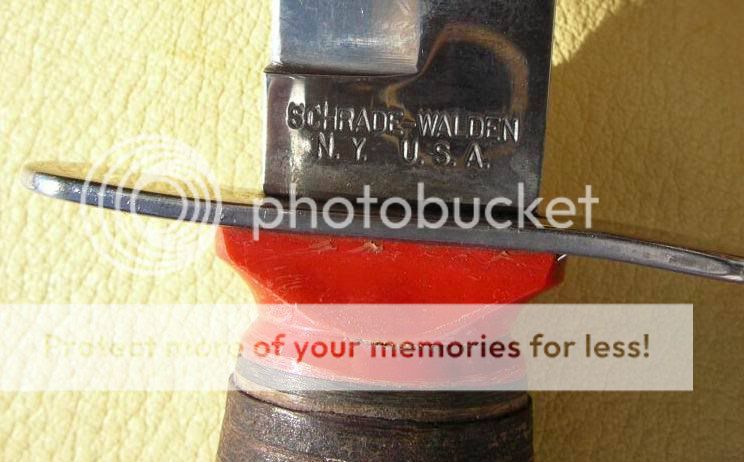

Here is a 9 7/8" Schrade-Walden/N.Y. U.S.A. knife and "tubular"? sheath. the pile side tang is unmarked. the blade is slightly tarnised but shiny, like chrome. it does not to me, appear to have been buffed, nor does the pile tang look ground. the mark side stamping is reasonably deep and very crisp. looks like new. the guard and pommel appear stainless, so if this is an H15 that would date it as '61-'72. any help here, esp. re: no pattern #. thanks, roland
I believe this is a 138L Bowie Hunter.
There were several varients of the basic H-15 pattern, and also the Imperial versions. Some of the parts for the Schrade Waldens were actually produced by and purchased from Imperial.
All of the variants were adapted from the MIL-K-8662 (AER) Pilot Survival Knife (16 October 1953 until 1957). Schrade won a bid in 1956 on 23,787 of this pattern knives for the Navy. The cost with sheath was ... $1.196 each. This last info from Frank Trzaska.
Both Imperial and SW variants can be found with pommels and guards of aluminum, stainless, or carbon steel. And the pommel attachment means varies as well. The civilian knives would never meet Mil-Spec in this regard.
The #138 "Bowie Hunter" had a 9 3/4" overall length, a saber ground carbon steel 5 1/8" clip point blade, leather washer handle with spacers, curved aluminum bowie style guard, and aluminum flat pommel. This pattern was a varient of the H-15. It was cataloged in1957, two years before the introduction of the H-15. It listed for $3.95 in 1962. 1973 ½ was the last year for this pattern, and it listed for $8.00. Your knife might well be stainless. Many of these were sold to Sears with an etch on the blade and the red spacers.

Thanks Codger. i'm just starting to acquire some older Schrade FBs. it's a whole new world !
what is the difference between a 138 and a 138L ? and why no pattern # on this knife ? was it common to omit it ?

thanks Upstream. that pic. is worth a thousand words. i see the handles are a little different and the Bowie Hunter has a curved guard. do yours have their pattern #s stamped on tang (138, H15) ? roland
Roland, no pattern #s, but they do conform to the drawings posted above as the 138L and 144L.
I see the Codge has got the scan thing figured out. Nice Sears variants!!!
Pattern numbers were sometimes included, sometimes not. The "L" suffix was a later advent when some patterns began having "S" suffixes indicating Staglon. "L", logically was for leather, and WW for Wonda-Wood, one of the early names for the polymer impregnated wood handles that evolved into Fibron (think LB-7). I've not seen these suffixes on a stamping, just ads, catalogs and factory paperwork. The same goes for special blade treatment suffixes like the STC for the tungsten carbide edged blades and the WE for Wonda-Edge serrated blades.

well thanks guys, lots of good education here. so i have a VG condition Schrade-Walden 138L Bowie Hunter with original sheath, for $26. this is only my 2nd Schrade collector FB (UH 167 mint, is the other), and i'm very happy with it. a really good deal for a 40 year old knife in great shape ! Schrade Rules ! roland

SW Ted WIlliams etched sheath knives would date roughly from circa 1961-1972. It is possible to find one prior to that with the J.C. Higgins "Our Own Brand" etch. Most of the Higgins branded knives (not all) date from the fifties/earliest sixties and are actually Western knives. Watch for that Platts patent number and the second pommel pin indicating a bifuricated (split) tang. This is another member's Higgins marked SW Bowie Hunter.
I do have these, but the photos are from my archives, not from my collection. Some day I'll get a good camera, tabletop tripod and build a small lightbox. Until then I have to use my archived photos. My scanner, an HP Photosmart C5140 is a great scanner, but it has no depth of field for scanning knives.
As a point of interest, compare the attachment means for the "Caps" (pommels) of your varients. You will see three or four different ones, including one drilled and pop-riveted, one smooth peened, and one peened with a drift punch. I don't have enough datable examples of these knives to do a proper survey of the method/pattern/dates.
Back to the pattern number markings, I have a couple of SW sheath knives where the pattern number is not stamped, but rather a tiny etch. Also the pattern number may be a seperate stamp on the non-mark side. You'll note how on most of the SW sheath knives, the mark side was blade left. Near the changeover to Schrade, it was moved to the more familiar blade right. Also, mostly as regarding the Craftsman stamped sheath knives, the tang stamping may be oriented either read from the blade tip, or from the handle. Earliest Craftsman branded sheath knives simply had the Craftsman logo and slogan, sometimes sears number etched on a blade with production SW tang markings.
