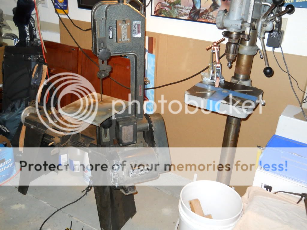

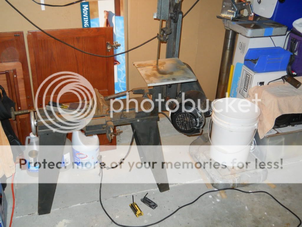

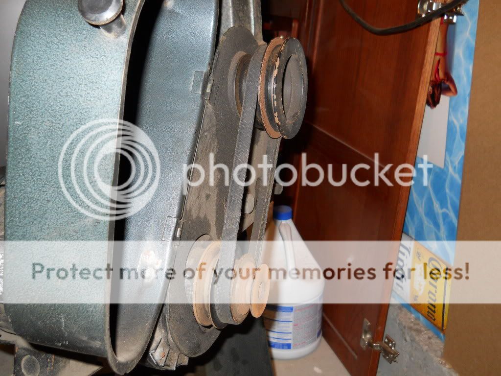

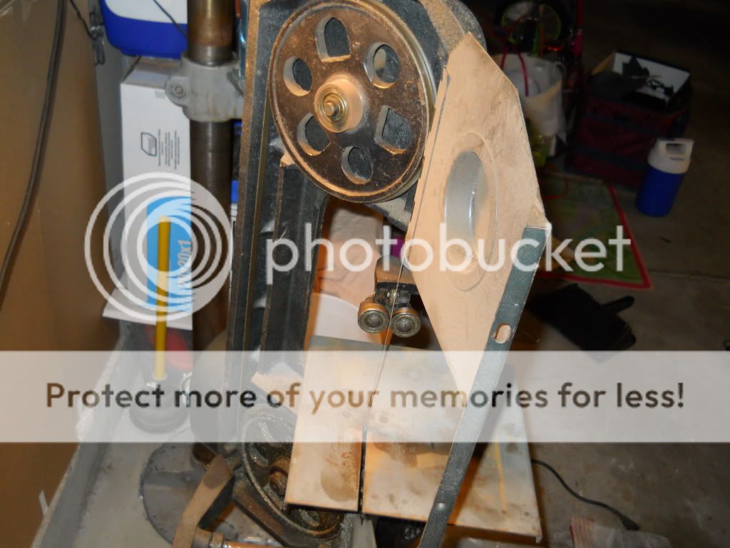

Got this from an old friend today who owns a heating and sheet metal company. It's been sitting in their shop for more than twenty years but it runs and cuts. It's an old metal cutting band saw build in Taiwan for Dayton in 1980. It has three speeds via step pulleys. Right now it's on the middle set. I plan on getting some new blades for it and giving it a general cleanup and adjustment. I already replaced the broken toggle switch this evening and I think this saw will work well once I give it a little spa treatment.
For cutting stainless can anyone recommend the best speed to set the saw at in order to extend blade life? If the stats on this saw are the same as the current version sold at Grainger, then the speed settings are 80, 120, and 200 FPM. I am cutting stock usually under 1/4".
Also, any recommendations for blade width and TPI? I figure something like a 1/2" blade at around 24 TPI, but I'm open to suggestions.
Here are some pics. Thanks!

You cannot use a blade that is narrower than 1/2 on this saw.
On a wood bandsaw, there is a rubber tire and crown on the wheel to create clearance for the extra width of the teeth set.
On this saw, they run the spine of the blade against a shoulder on the wheel and rely on the 1/2 blade width to clear the front of the wheel.

Now the first things you need to do is to change the toggle switch to a foot switch. Then remove the vise and all the hardware from the bed. Next, make a seat to bolt on the bed ,so you can sit comfortably while sawing.Before I bench mounted my saw, I had an old English saddle on it.
OR
Take the hinge pin out and mount the saw on the workbench end. It requires only a few angle brackets and a back brace to make it a permanent upright saw. Mount the motor on the bench behind the saw. The bed is fine if you have lots of floor space to waste, but it is at the right height when bench mounted...and takes up one sq ft.
