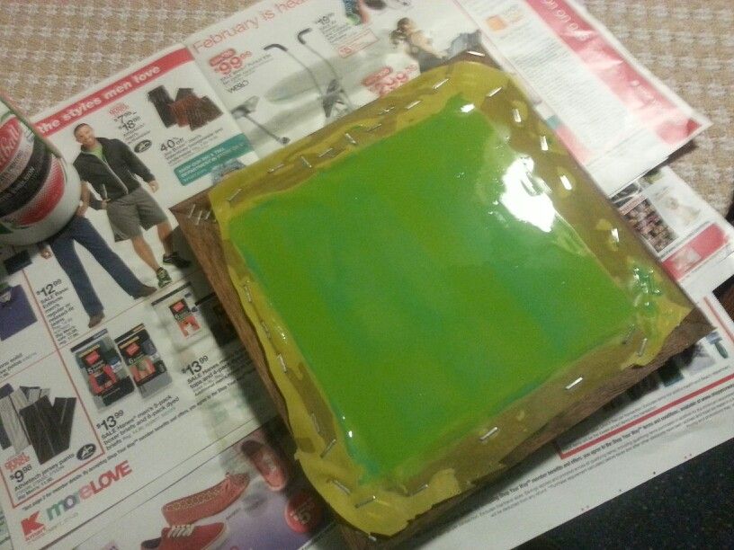

Now, we need a squeegee. I like the bondo squeegee's because they are cheap, easy to clean, and you can work them a bit to soften them. I have used bondo squeegee's for years, and learned with a little bit of working they can be softened and the edge can be worked against a jeans clad leg to give a bit smoother pull across materials.
Pour yourself a little emulsion on the screen in a nice straight line across one side of the screen... A little goes a long way. Let me repeat that... A little goes A LONG WAY with this stuff.
We want a nice thin coat, after all we are just trying to block the pores in the mesh, nothing more. Thick is great for those big blocky images the screenprint shops are going for most times, but for a small image we want it nice and thin. Spread it on with nice even strokes. It will push through to a degree, and when it does, flip the screen and squeegee it the opposite way. This stuff is light sensitive, so don't go crazy with the lights, but at this point it isn't as sensitive as it is when it's dry
Now, you should end up with a nice even coat on the screen. It should more or less look like this...
Now we need to put it in a nice dark place to dry. Keep a watch on it, we don't want it to dry and then sit for a long time as the emulsion will set up without light exposure if it just happens to sit for too long. Yes, I am setting it on my snare-drum for those that have sharp eyes and recognize the Remo pinstripe heads... Setting the frame up on some small blocks will help air to circulate and dry a little quicker.

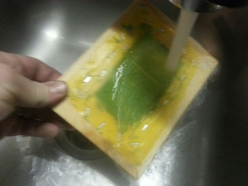

Now, after exposure is a time sensitive little bit of running. You should have your washout area set up as advised previously. Immediately after removing your image and emulsion from the light, get it to the sink and start the washout process. A steady stream will wash away any unexposed parts of the emulsion. You can probably see the image in the emulsion at this point as a very light variation in color between the two differing emulsion exposures. Just scrub until the image is clear. Too much water will soften the emulsion and it can be scrubbed off the screen.
Here is another washout shot, in this one you can faintly see (well, it would be better if it wasn't as blurry but I am my own photographer) the image showing up. This is a very small screen I did for a single cursive 'Overmountain' logo.

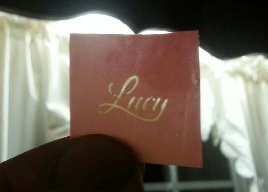

Again, inconsistent picture taking here... This is an etch I did with a design that was supposed to look like an old printing press laid it down. Now, I will cover filling the pin holes in the screens later, but here I left them because I wanted that splattery look. This was done as a nameplate for my drill press... and just for photographic value... It was artificially patina'd steel as well etc...

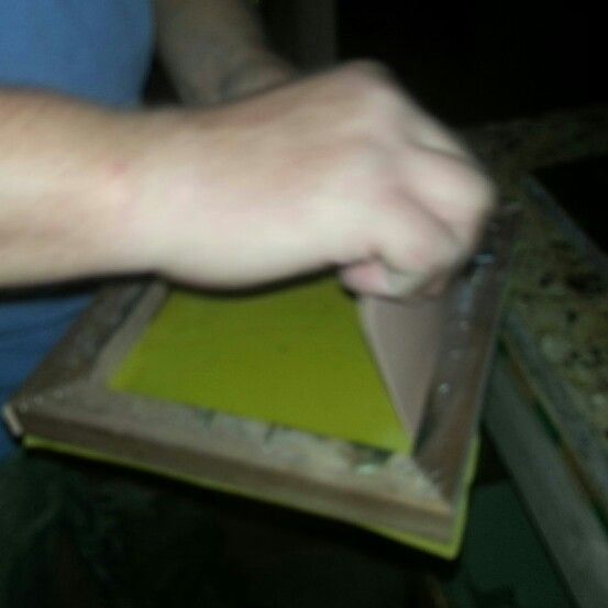

Ok, the process from this point on is pretty much the same. You want to start squeegeeing the mesh onto the emulsion.
The adhesion problems seem to be a failure to properly squeegee everything together. I had issues the first couple of time, and you will see some missing parts of the emulsion in some of my pics in a few, but noticed this start to go away as I got better at my technique. You should start to see the emulsion coming through the mesh. Add a couple of drops of water as you go about squeegeeing the mesh and is dries out. Once you are pushing a good bit of pink around, the emulsion is pretty well adhered.
After the emulsion is thoroughly on the mesh, you can place it somewhere to dry. The sheet that is not in a frame has to be hung up obviously, but the frame can be set aside like before.. You can remove the plastic backer at this point, or when it is dry. It will tend to take a little of the emulsion with it when it is still wet, but it speeds up the drying to have it gone. I wasn't in a hurry with the one in a frame, so I left it on, but for the one out of a frame here I was short on time so I took it off. You can see a couple of places where it took emulsion with it. This can be blamed on my technique as I didn't get it into the mesh enough. Later attempts were a bit better.... None the less, it will work fine for our purposes.

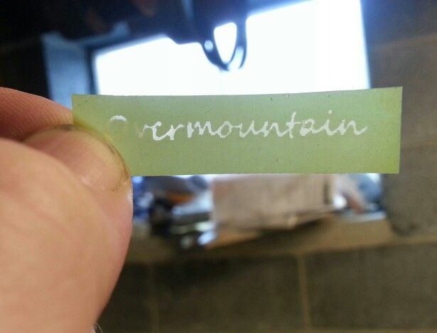

Here is the logo I am doing on this sheet. Placing a paper towel between the transparencies and making sure I don't slide them has so far allowed me to hang on to these sheets for later use. As an alternative, one could always use a heavy black paint that is a good light blocking paint and paint a logo or design on clear plastic to transfer it to the emulsion.
After the emulsion is dry on the mesh, same as before, time to expose it. Lay the transparency down on the emulsion, place a piece of glass or heavy plexi on top to help hold it as flat to the surface of the emulsion as possible. I used the same setup as before, the work light with a 250W bulb. In this instance it only took a couple of minutes of exposure instead of the 45 minutes the Speedball took. The light was also able to be placed a little farther away, which helped keep everything nice and cool. You can see a little stretching in the mesh that was not on a frame. Another reason I recommend using one.
Once again, after it is exposed, rinse the unexposed emulsion from the sheet in the same manner as before. This does need to be done quickly, not 1095 quenching territory, but don't dilly dally. I discovered the Ryocap also washes out a lot easier than the Speedball. Again, as J pointed out, there are much better products out there obviously. While washing, you can hold the design up to the light to see that everything is coming out as it should.
After everything is washed clean, you can set the mesh out in the sun to let it dry and also set the emulsion just a bit more. If it is raining, pop it back under the bulb you used for exposing the design... After everything is nice and dry, you can inspect your results. Here, you will see how mine turned out and notice that there were a few spots where the emulsion didn't adhere to the screen. If we were doing a t-shirt, this would have been a no go. For something as small as a logo to be etched, it isn't that big of a deal... Keep in mind here also, this is a pretty small logo...
At this point, I pick out the keepers from the throw aways and cut them out. Remember to leave enough space around the logo to put down some vinyl tape. I hold them up to the light and look for pin holes...

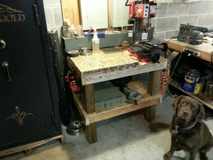

Thank you Eric for this, it is appreciated. Yet another example that we almost literally have to know something about everything just to make a knife! :eek:
Oh, and that's a good looking work bench!
Chris
Thank you... That was the sharp eyes part!
In part one it was bare wood... part two I had my granite!
I have the free use of a Bridgeport Series 1, but I have to drive 20miles to get there. I drive lifted quad cab F-250 'stroke... Diesel ain't exactly cheap. So, I managed to convince myself and HRH that I needed a little mill/drill or something as 80% of what I do could be done on one and done in the time it takes me to drive up there. So, after a lot of looking at worn out equipment, and a bunch of other crap, I decided to pick up one of the HF jobs. For all of people's griping, it really is a nice machine. Clean up the cosmoline, lap it a bit, tighten this and loosen that and it runs like a champ. So, I needed a table for it has been taking up real estate on my workbench that I need badly for mowing season.
So, after over building this table, I decided it would be nice to have a big hunk of granite to work on. Basically a surface plate that can be worked on. Granite is dead flat and cleans up nicely.... So I made a visit to Design by Nature here locally. They do nothing but granite. I told them I needed a 2'x2' piece as thick as they had. She asked if it was for a vanity. I told her a workbench top and I'd take the ugliest stuff they had. She instead offered up anything I wanted from their bone yard and even offered to cut it... So I wound up with this piece of choice stuff and an 8"x8" 3/4" thick piece for sanding and such. As well as an offer for anything else I needed if i wanted to cover other surfaces. Man, the generosity of some people actually gives me faith in humanity sometimes.
So here that is finished out with my constant shop companion... (except she goes elsewhere when I'm using chemicals, grinding, or sanding.) Have to consider her lungs too...
And yes, I have discovered that knifemaking calls on almost everything I've learned about working materials and such, as well as requiring us to constantly learn new little things as we go...

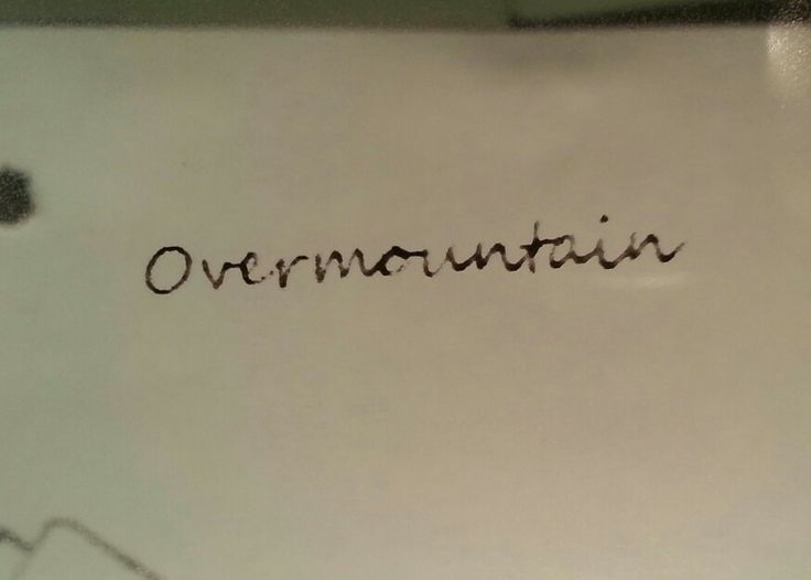

Just a quick update on my experience...I remade my stencil using a slightly thicker application of emulsion. To etch, I used a battery charger, piece of felt and salt water.
This is an absolutely workable solution, especially if you already have the materials handy.

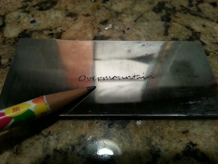

Here are the results on my latest knife.
Nice deep etch.
A few tips:
Placement is poor. The mark is in the middle of the blade. It would be far better placed just below the spine near the ricasso.
While not to big, it is a bit larger than most. This is partly due to the stencil making method I would guess.
The etch is only an etch at this point. The mark is made by using AC voltage after the DC etch. On most etcher systems this is done by flipping a switch to bypass the bridge rectifier. This will make the etch turn darker.
Thanks for the tips Stacy. The size of the mark is sort of arbitrary. That's just the size I printed, and although I have printed smaller I haven't tested the limits on size yet. And sadly, I don't have a means of marking yet. Maybe soon.
If the battery charger is one for a car, just wire in a SPDT by-pass witch that takes the bridge rectifier out of the circuit. That will deliver 12VAC instead of 12VDC.
If it is a modular plug-in type, like from a computer power supply, you can't do anything to it.
It is a car battery charger. Can you provide any further instructions on how to wire the switch? I would like to try it.
