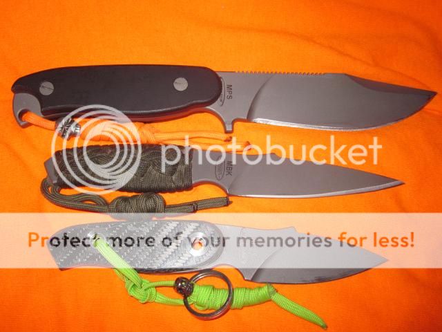

For a knife which will spend considerable time exposed to salt water, I prefer titanium.
Specifically the MISSION knives. Here three of mine:

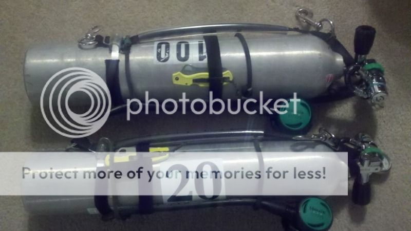

and for the most part the sheath holds the knife securely and I have had no trouble affixing them to my BC. if you lose them, you aren't out a lot of money. I've used dedicated diving knives to dig and probe underwater before but have found them extremely lacking in cutting ability due both to the steel and the blade shape. The one plus to them is that the thick handles make using them with gloves on easy. A Vic paring knife is hard to use with gloves due to its thin handle. You CAN get them with a plastic aftermarket sheath and an aftermarket handle if you look hard enough. Try googling for "Plante Vic Knife" and you should be able to see the knife and sheath.
