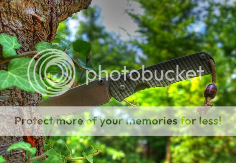

I didn't modify these myself but a fella by the name of Tom Mayo did and they came out a little better then if I had done them :D
Work includes;
dual custom studs
color anodizing
blade polishing and sharpening
action smoothing
lots of holes
dave
I love those thumb lugs! Do the lugs on the seb screw in or are they press fit?

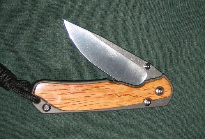

I satin-polished both scales & clip on mine, feels better in the hand (smudges are just smudges).
I like the holes too - but what I wish I had done, in retrospect, was the cool grip sculpting this other fellow did . . . .

I'm just wondering how the fit between the blade, washer and new scale is when you guys replace the standard front scales with G10 etc??
How do you manage to keep the fine tolerances and not have blade play?
If the scale is flat on the inside (and it is by default) than it's as goood as Ti. I have ZERO blade play. The tollerances are in the blade/washers/pivot/bushing and not in scales as such. Scales just need to be FLAT :)
