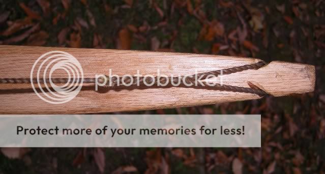

I'm continuing my experiment with the goal of killing small game with a selfbow and primitive arrows. I built two arrows in this thread.
I got to work more on the bow this weekend. The bow started as a maple sapling about 2" in diameter. I cut it down to a stave and trimmed it with stone tools. That was good, but i made me realize that it was far too slow, so I switched to a hatchet, a mora and a Hultafors GK as those were handy.
I used the hatchet to hack the stave in half, trying to get the D shape that I've seen in my research. That took about an hour. I should mention that I did not debark the staff. I wonder how that will affect the bow.
Then I started whittling with the knives. After quite a pile of shavings, it was ready (in my mind) for a first stringing. I used paracord. I may end up making a sisal or milkweed string as time permits but I hope to hunt with it this weekend if all works out and I don't break it.
As you can see, it still needs work. The left side is stiff so I'll be shaving it down a bit. I'm looking for more of a gradual D shape and I want a draw length of at least 24" I'm a little concerned that it won't have a decent draw weight. Looks like around 30-35 pounds, which is OK.
Another thing to note that was a good lesson for me is that the staff is full of knots. I figured in a survival situation use what is on hand, but if I took the time to pick a knotless staff of either oak or hickory, common here, I'd be better off for the same amount of work.
Here are some pictures. Any advice from those real bowyers out there?

First, de-bark the stave. Leaving the transitional cambium layer attached will slow down the action of the bow. Leaving the extra weight of the bark attached will slow it down even further. Weight isn't everything. Speed is just as important. Although you may lose a pound or three by removing the bark you will actually gain some speed in the arrow. If you decide to remove the bark be sure not to damage the growth rings of the stave. Also, the bark removal will help the stave to dry quicker and more evenly.

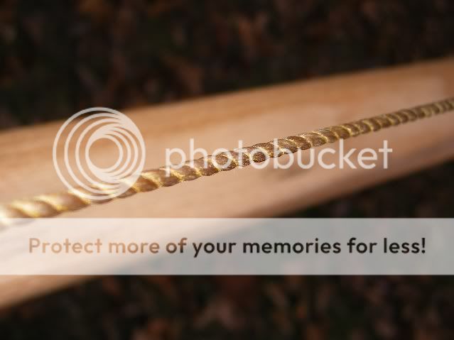

Second, use a better string. Paracord stretches and is one of the worst materials for a bowstring. The stretch comes from the sheath. By removing the sheath and using just the inner strands you can eliminate most of the stretch and still have enough strength to make a bowstring by braiding, twining, or making a flemish twist.
Third, please don't waste your time making a bowstring out of sisal or milkweed. Both of those are FAR to weak to be used as a bowstring. Very few plant fibers are strong enough to be use as bowstrings. Most "primitive" bowstrings were made of animal parts. Split hide, sinews, gut cord, and plant fibers. The latter was used by the fewest groups. Yucca and dogbane make suitable bowstrings if processed properly. If you want to make an authentic looking bowstring without the effort of gathering and processing then try hemp string from a craft store or walmart. It is stronger than any natural fiber you will find locally and is good for practicing making whatever type of bowstring you prefer.
If you make a shelf for the arrow then an easy way to make a nock is to make a mark on the string with a sharpie and then tie a single overhand knot at the mark. The knot will now act as your nock. Be aware that this only works if your string is strong enough because the knot will reduce the total strength of your string by appx 50%.
In the second picture, your tiller isn't even. You have a thin spot near the handle and then a lot of thickness half way to the tip. The goal (MUCH EASIER SAID THAN DONE) is to have the limb flex evenly from handle to tip.
When tillering, remember that half the materials thickness taken from the belly will cut the bows draw weight in half but removing only one quarter of the material thickness from the sides of the bow will cut the draw weight by half. If you want to strengthen your bow after material is removed you can back the bow. Its more intensive than it sounds so I won't bother posting about it but you can PM me if you're interested.

imho you've gone too far with green wood. Unless it isnt green, I think that will effect your cast more than anything. It's ok to work it to rough size green; just dont bend it or tiller too much. Dont work it beyond it's final draw weight. And with 2 inch maple you likely want to keep it as wide as possible. Good luck with it.

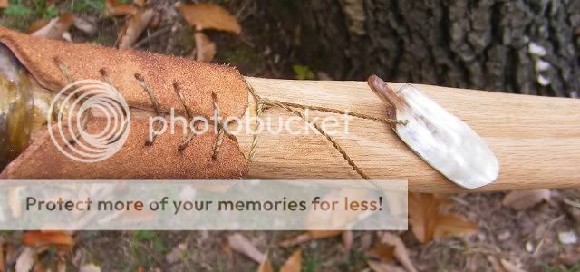

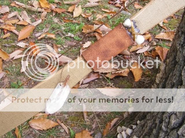

Good luck with the bow. I love both traditional and primitive archery and am happy to see so many people on this forum interested in it. I'm half way through a new design of 100% primitive "stump" arrows for small game hunting with a heavier bow. I'm going crow hunting on Thursday and if I get enough big ones I'll fletch the arrows I have made up.
P.S. just finished this string a few minutes ago. Tighter than I usually like but the extra twists were needed to make the brace height 5.5 inches (correct height for the bow).
Here is the deer hide handle, tied with artificial sinew, and decorated with a carved bone feather. The arrow rest is a round cut deer leg bone.
