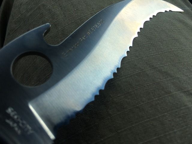

I own, use and constantly sharpen my huge collection of Spyderco knives. And almost 45% of them are serrated edged, mainly Spyderco's Spyderedged blades. Albeit I know that there are a lot of different serrated edge patterns out there made by several different knife companies. Many of the serrated edge patterns out there commercially available would require a wide range of different sharpening tools to be able to sharpen most of the serrated edges currently on the market.
However the largest percentage of serrated edged blades that I own and use a lot are Spyderco's. Now Spyderco themselves as many of you know has a few different types of serration patterns but most of them are the spike & scallop type serrations that you see a lot of their newer knives. I know that there must be several ways to sharpen most of the more popular serrations currently on the market and I already have mastered a couple of good methods of sharpening a few of the more popular serration patterns but I would really like to pick everyone's brain and see what wide range of methods are out there.
Most of the Sharpening Tools I use for sharpening serrated edges are made by Spyderco. My very favorite sharpening tool is Spyderco's older/discontinued 701 Profile set ( ceramic file set) that they sold for years. I also use Spyderco's great 204 Sharpmaker for some types of serrated edges. But I'm always looking for newer/better ways of sharpening. So let's talk about sharpening serrated edges>>any pattern you might want to talk about. And please tell us what sharpening tools you use? Also any stropping methods that would help as well?
Normally I just lightly hit the back and strop on a bookend type strop to clean it up. If they need rebuilding or I want to do a super nice job I use the method in this video:

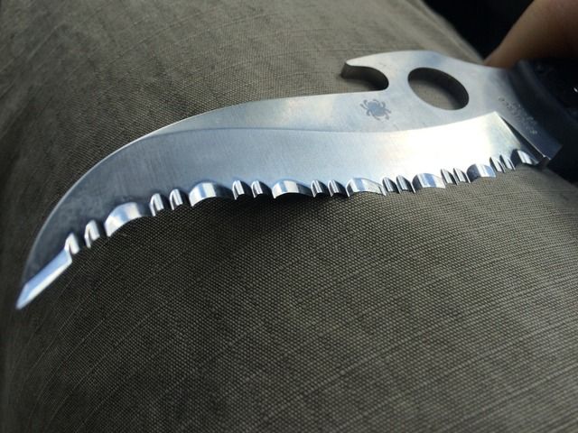

I start by almost never messing with the face of the serration
I instead only sharpen the backside at the lowest angle possible. On hollow ground blades I simply lay the blade on the stone like a Scandi edge and make a few light passes until the burr forms on the face side. Once the burr has formed I take it to my leather wheel on my variable speed grinder and polish both sides. In some cases, such as bread knives, I will just use my belt grinder following the same procedure.
This spyderco has a handful of sharpenings already yet still looks new.

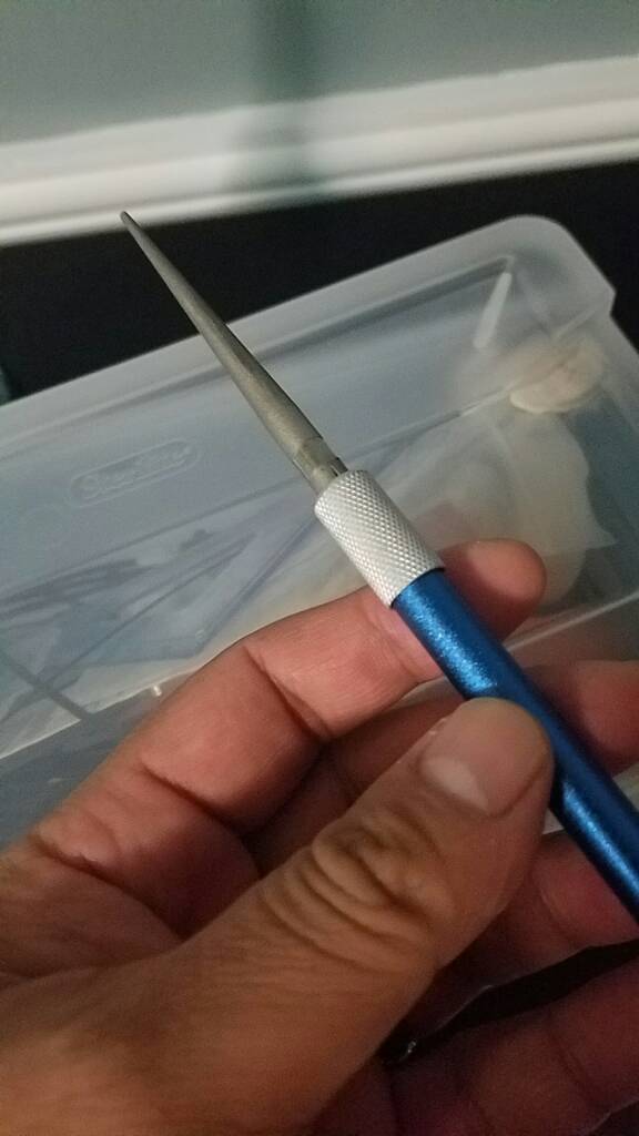

Smith's diamond coated pen rod for me... Works great!
Sent from my SM-G930V using Tapatalk
Or just get one of these for 8 bucks!
I don't get the cone shaped sharpeners. The cone only fits the serration at one point along its length. As soon as you move it, it's only sharpening the bottom of the tooth, not the top where you really need it to be sharp.
