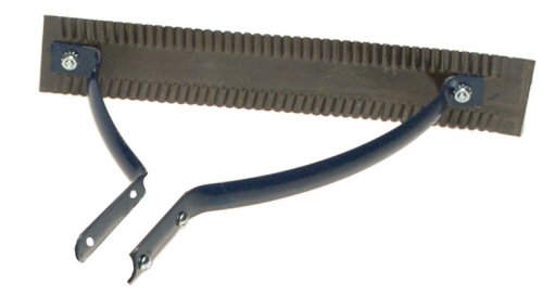

That's what I was thinking. I have a grass cutter like the pic below. Works fine, but that's about the only specific use I can think of where serrations would really come in handy.
Grass would be easier to cut with a straight edge wouldn't it? If the serrations aren't sharp, even if they are really, wouldn't it drag through instead of cut cleanly?
The one issue with the tool I showed above is that eventually the blade gets wet enough from the grass and weeds that stuff starts to stick to it, clogging up the serrations so it stops cutting and starts tearing. I just pull the gunk off and keep going. When the serrations are clear, though, it cuts very well. Larger serrations like 2jka suggested would likely be much better.

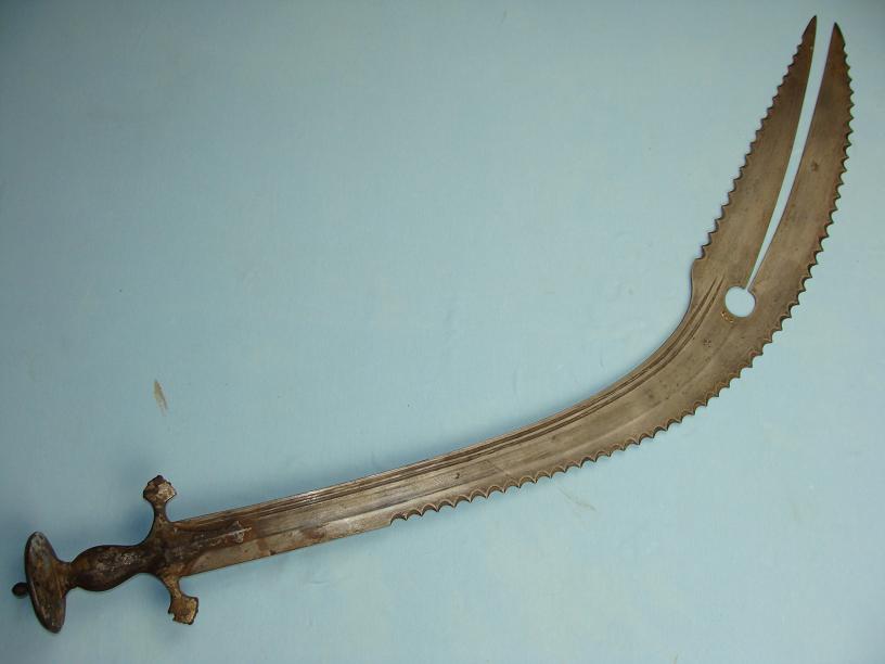

Something like this? :D (yes--it's real)
But seriously, though, it'd work just fine. What you'd want to do is establish a bevel on one side only and cut the serrations on the opposite side. If you're mostly making cuts from right to left you'll want the serrations on the left blade face so they'd be facing upwards when making the cut. When field sharpening, sharpen the beveled backside only, but occasionally reset the serrations with the tool you used to make them. A chainsaw file would do the job handily. An easy way to get them spaced uniformly is to mark out the lines where you want them (this is the obvious part--the following less so.) Use a triangular or knife-edge file to cut a small starting groove where you marked each line. This forms a channel that will keep the round chainsaw file from sliding off track while cutting the serration.
Serrated sickles were common in the Western world, actually--it's just we've forgotten a lot of the heritage of North American manual agricultural tools. The serrations were factory-cut and the backside given a very thin bevel. The backside was all you'd ever sharpen since the factory cut the serrations so the grooves ran almost all the way up to the spine. The more the back bevel was sharpened the edge would just travel up the grooves, so they'd never be sharpened away until the tool was basically used up.
If you do it, do it with a dedicated lush vegetation pattern like a sable or guarizama. The serrations technically won't keep you from chopping wood or anything, but they'll be more prone towards being damaged by lateral strain that can easily occur during wood chopping. Best to stick with a pattern that's only for vegetation. I'm actually pretty tempted to experiment with a guarizama now and see how it plays out.
I'd consider a scythe for serious vegetation clearing where it's an option, though. Those are REALLY fun. A machete would do fine for taking care of stuff that's surrounded by obstacles like stumps and the like ("spot targets" so to speak) but if working in a more open space it wouldn't be able to keep pace with a scythe. My two favorite tools, right there! Few things I enjoy more than getting in some good machete and scythe time. :cool:
Agreed - I've used those, too, but it is a completely different sort of motion.

Also, regarding the "weed cutter" I suggest avoiding those at all costs. They were mostly given to farmhands that were too rough and clumsy to use a scythe without breaking it. The scythe (yes--even the American pattern!) was and still is a tool of finesse, while weed cutters are tools of pure brawn.
