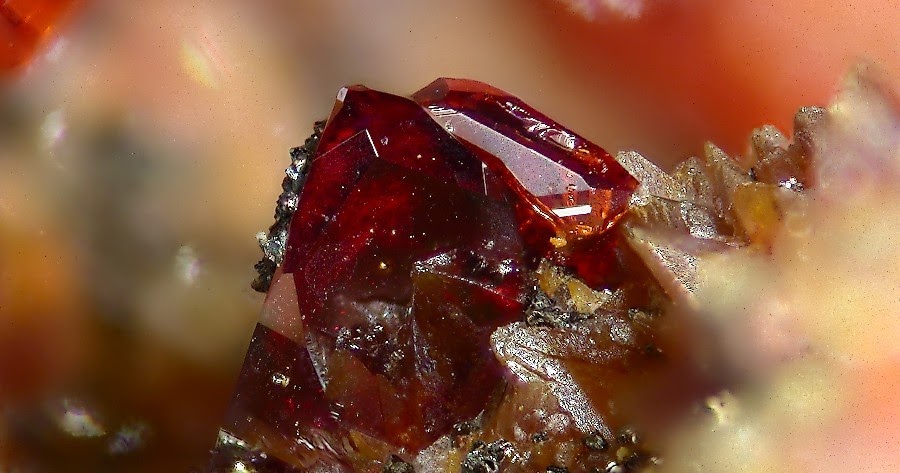

I know that Stacy .We just call them here red ruby , pink ruby ...etc .There are a lot of them in the area where I live. As children we found a lot of them ... my brother still keeps one big as a fist .
My friend grind this one on picture ............You would like to meat him , he use tools for grinding precious stones same as in ancient times....he doesn’t let me take pictures or record when I’m in his shop .
This is of topic but i think that you would like to read................
I don't know if this would work out not, but you could try inlaying a thick piece of silver or gold, then drill holes in the softer metal to place your gemstones...
I thought of something like that and I'll probably try it . The hole at end is the reverse cone just for that , to hold metal or epoxy better ......
Well , I will just glue this ruby in the hole .....looks enough good to me :)
