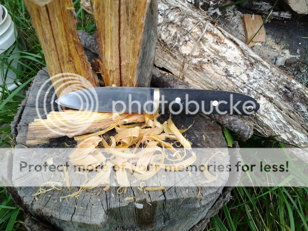

I have a knife I use a lot with stall mat scales, I am a big fan of the material. It is comfortable over a long day of use...
it isnt pretty but here it is. raking the 60 grit belt with an old end mill did the trick ( thanks, James T.)
