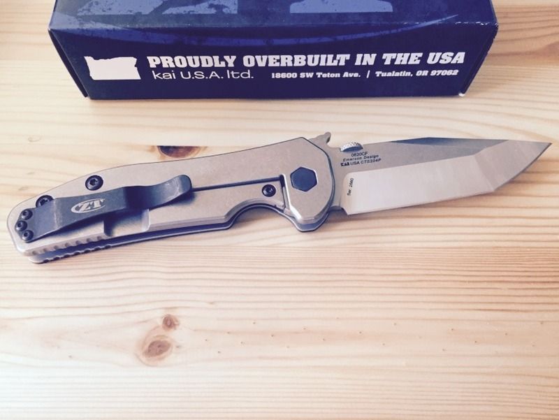

Well just picked up my first Tanto Blade a ZT 0620 CF and what a sweet knife I really like it !

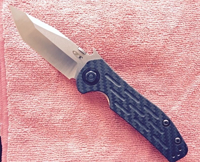

But being my first Tanto Blade as mentioned I'm not sure the best way or how to sharpen it using my Apex Edge Pro . I've pretty much got it down and can produce a razor sharp edge on my other blades but this Tanto has me wondering what's the best way and I'm thinking you just treat it like two separate edges when sharpening it . Best way and tips would be greatly appreciated . It's hair shaving razor sharp out of the box but just planning ahead for its first sharpening session.Here's a few pictures of my new love [emoji41]
That's what I do with my tanto blades. I don't have an Edge Pro, but whether freehanding or using my Aligner set, I just treat them as two separate edges.

Thanks , that's what I was I hoping . I didn't want to screw it up that's for sure especially on its first trip to the sharpening bench .

EDIT: Funny how that first pic shows some definite belly in your leading edge then the next pic it looks totally straight. Assuming the belly is there that should make a nifty slicing edge, huh? I tend to keep a straighter leading edge on my knives but I bet you'll really like that blade.
I agree, treat it as two separate edges. I did that with my Wicked Edge and I couldn't be happier with the result.
Great advice thanks , yup she's got a little belly on her : ) looking forward to some tasks with it and adjust to the use of the Tanto shape blade . I believe they refer to this one as The American Tanto because of the slight belly .
