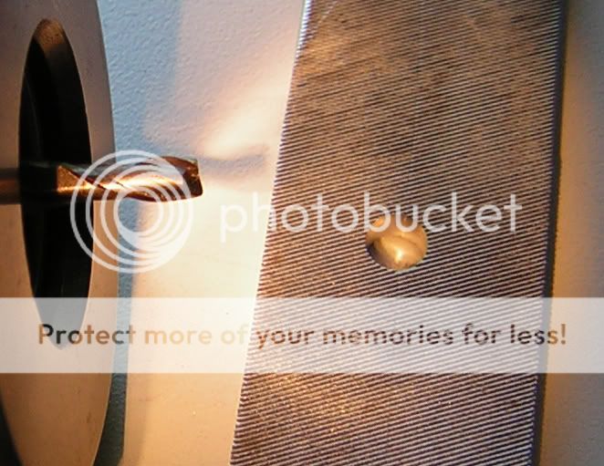

+1 on using a carbide endmill to put holes in hard steel. I did this a while ago to prove it could be done. Carbide endmill and a fine helical toolpath to get around the "dead zone" in the center of the cut. Notice the fine finish and the healthy cutter.
