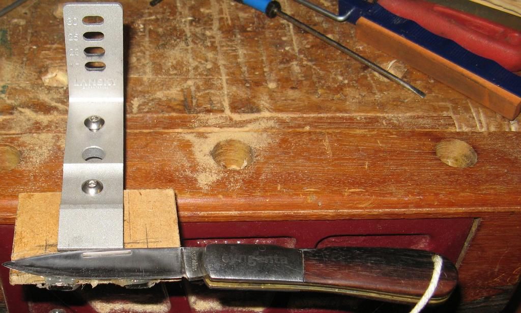

How wide are the blades on your knives? The Lansky clamp system can't handle blades narrower than around 1", below that the stone will hit the clamp rather than the blade. I've made a temporary jig for narrow blades so there is a solution, but just warning that out of the box the Lansky doesn't really suit pocket knives.
Then that probably won't work. My Rat2 is the narrowest at about 3/4 of an inch. Then I have another 3 Kershaws than come in at just under 1".
Here's the first draft of an adapter I made for sharpening narrow blades with the Lansky hones. Still some challenges in terms of ease of use.
That is absolute not true, at least not for the older type clamps which have the notch for smaller blades but with care can also be done with the clamps without the notch.
Here are two pictures with a standard Victorinox knife with a blade width of 1/2" one on the 17 degrees setting and the other one at the 20 degrees setting both work well without hitting the clamp.
Lansky 17 degrees by Frans van de Kamp, on Flickr
Lansky 20 degrees by Frans van de Kamp, on Flickr
BTW The angle settings on the Lansky clamp are just an indication and the actual angle will depend on how far the knife sticks out from the clamp. With this knife the actual sharpening angles are:
13.3 degrees on the 17 degrees setting
17.4 degrees on the 20 degrees setting
21.5 degrees on the 25 degrees setting
25.3 degrees on the 30 degrees setting
I can without a problem sharpen smaller knifes as well on the Lansky so in contrast to aesmith, I would say that the Lansky is perfect for pocket knifes
