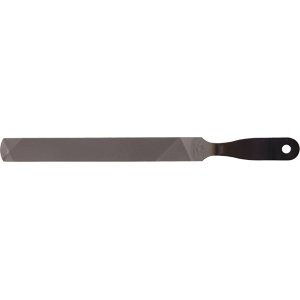

Among many other brands (some vintage), I own several fine Granfors axes in all sizes. The full-sized axes are kept sharp by removing chips and dents with a Nicholson Black Diamond "Handy File", double cut on one side, single cut on the other. These can be purchased from many of the larger stores in the Home & Garden sections or, from your local logging supplies retailer. Once the chips are removed from the edge with the file, I move to a medium whetstone, then complete the task on a fine whetstone. This will do for active wood chopping. "Maintaining" will be easier than sharpening but the small chips and dents will happen.
At home, I sometimes take the leisure to maintain the mirror finish blade and laser sharp bit on my 'occasional use' axes. Other than some fancy machinery to do this with in the shop, I will often use a hard rubber-backed block sander (drywall style) that clamps the abrasive paper securely in place. Working through the grits, finishing up on a strop loaded with honing compound, will give the finest of polished edges that one could desire and admire. Make sure to "tailor" that grind and edge for the task and environment that you will be working in. What I use on my softwood trees won't be the best choice for what the next guy uses on his hardwood trees. Sometimes a compromise is the best choice for the bushwhacker (cutting and splitting) and his limited needs (by comparison).
The "Handy File". Note the handle shape for ease of use.

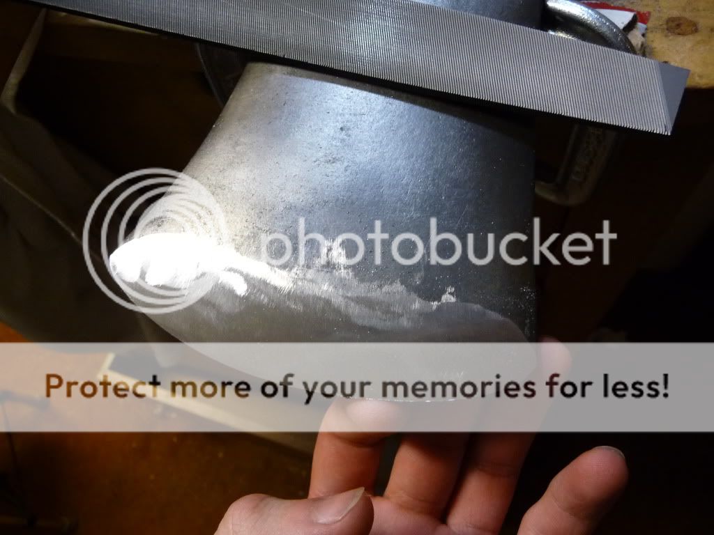

I sharpen using both the traditional method (file + stones + stropping) as well as the more modern method (sandpaper on soft backing). Both have their advantages and you can easily put a shaving sharp edge on an axe using either.
Vintage Gransfors Bruks double-bit sharpened using sandpaper up to 2000grit on mousepad then stropped on .3micron chrom oxide loaded leather:
Keen Kutter sharpened the traditional way using a Nicholson mill bastard file, followed by a DMT double sided diasharp in coarse/fine, then a soft arkansas stone and finally stropped on leather:
The latter I wrote in a bit of a how-to fashion, so it might be worth a read if you want to get similar results :)
