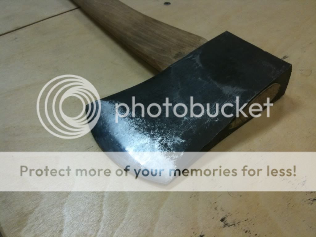

Spent an hour or so putting a new edge on an old Collins Old Timer this weekend and got curious on how some of the other forum members might sharpen their axes. It seems everyone has their own preferred way, it'd be interesting to hear about them.
I start with a Bastard file if I need to reprofile. Then I go through 4 DMT Diafolds, extra coarse to extra fine. Then finish off with DMT Diapaste on a leather strip. This gets me almost to a mirror polish. Takes a little time upfront, but not too much to maintain. I take the fine/extra fine diamond file with me out in the field to touch up an edge if I need to. I've never been a fan of pocket stones. I have the one sold by GB, but prefer my diamond files. Interested to hear from the folks that like them, and how they use them.
Here's what the above process produces:

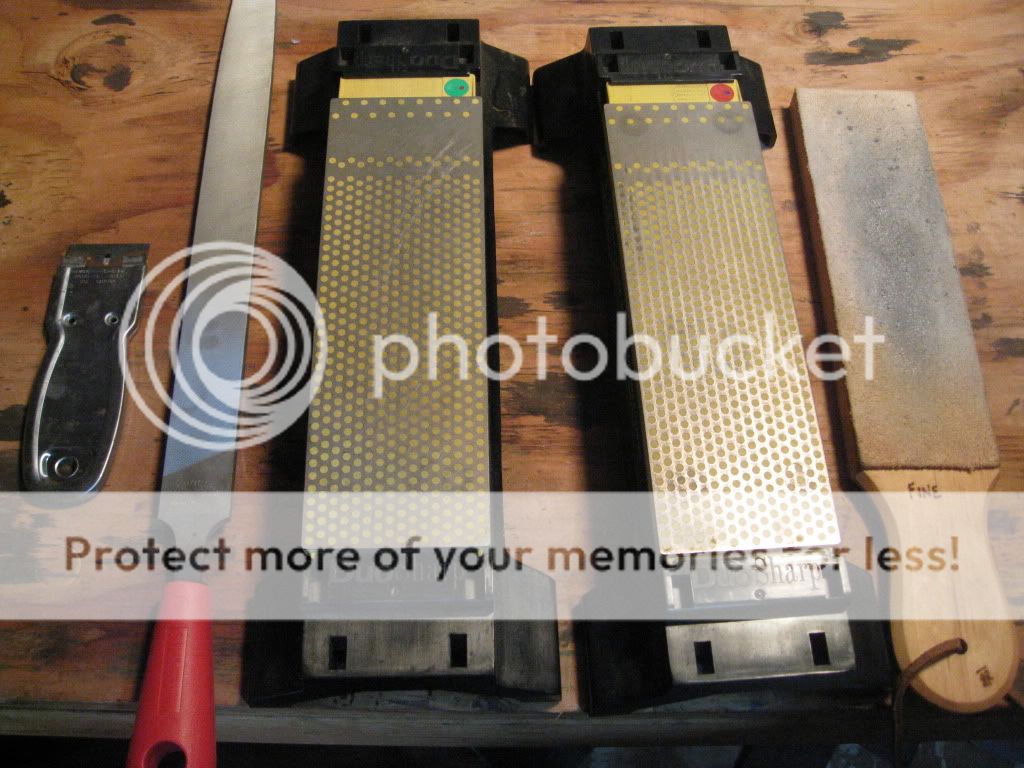

I maintain edge a couple different ways. I have a couple small fine stones I can throw in the pack, or use the schrade hone-steel I got. The hone-steel does wonders.
I used to use a stone - start with a puck (assuming a file wasn't needed to get it going), then move up to a soft Arkansas that's fat enough to hold like a puck. Then I bought some silicon carbide belts for my 3x21 sander and was using those for a few, but ended up cutting the splice out of them and gluing them to some hardwood boards. Now I use them like an 18" bench stone. I made a few similarly sized strops and use this setup for my larger knives/machetes and my axes and hatchets. Coming off of an 800 grit belt and stropping with some white compound produces a very nice edge. Truthfully, it works so well I might use it for all my knives, but then I'd have to order some spare belts - with all the stones I have cannot justify any more $ for sharpening supplies. Not sure why, but the bonded belts make a much nicer edge than sandpaper.
I'll start with a file if necessary but usually I'll start with the coarse diamond plate and finish with the strop. I bought a Lansky puck recently but haven't been able to match the results with my normal set up. I'm going to continue working on my technique with the puck because it would be nice to have just one two sided puck to keep track of.

Alot of times I balk at lack of efficiency in certain techniques and tools only to find out there's a specific design that has been perpetuated for a reason-it works. One of these tools/methods is a puck style sharpener, and it has been paired with the task of sharpening axes for a very long time. I'm by no means an expert sharpener, but do pride myself when it comes to tool preparation and maintenance, so take my experience for what you will. It seems to me that rectangular sharpeners with hard flat edges make achieving a really natural smooth consistent convex edge very hard, which is what you really want for an axe. But when using a round puck sharpener, both running the stone straight and grinding with a circular motion will give you a really smooth fantastic convex edge. It makes sharpening quite foolproof and natural. What I do is take a glass jar, soak it in water, and lay out a couple of two inch strips of cardboard. If you're removing alot of material your stone will get gunked up fast, and soaking in water will prevent the pores from being filled up with metal shavings. when the water starts running black, wipe the stone off on a strip of cardboard leaving a nice clean maintained stone. Soak it again, and have at it. Operator is right in that the first concern is the larger profile, and if you're doing some serious edge work, it's important to make sure you're not trying to force a steep angle because your edge has been ground down to thicker portions of the bit. Most of the time this is needed just after mangling an edge or profiling when I first get the axe. The second thing I do is take one of those HI chakma honing steel deals and pull any rolled edges out straight, so that when I'm sharpening I'm not needlessly grinding extra material or just mushing down a mushroomed edge with my stone. Only at that point do I put abrasive material to the axe edge, and at that point usually little work is required. A couple of passes with the rough side of the puck, a couple of passes with the fine side of the puck, and if I get picky I'll run some wet-and-dry up to 2000 grit over the edge. Some steels take more work than others but that Scandinavian steel that Gransfors and Wetterlings uses sure makes life easy. I've never had an easy time profiling axes with files-usually I save those for machetes. If I have to do some real material removal I'll get one of the 5 dollar bench blocks at ACE and get vigorous with the rough edge. For whatever reason it seems to be alot more efficient running an 8x2 stone than a thin unwieldly long file when you're looking for precision in the profiling. They usually last me a good 7 or 8 reprofiling sessions before the stone is all bowed out and filled up with shavings, but if you really want to keep em going just soak em in gas and scrub them down with a scrounge pad.
I use files for profiling and occasionally a belt sander (I have a 4x36 and my dad has a 2x72). I sharpen with a double sided smith's diamond hone. I like the diamond hone because it never gets out of shape, it's easy to clean, can be lubricated with oil or spit works good, and I can sharpen practically anything with it. Makes a great tool to throw in your pack without bringing a whole sharpening kit. I almost always carry a small loaded leather strop as well.
